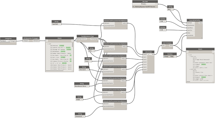

I am working on a script to export Furniture data to excel (and in return import that data back to revit). I am able to export any of the type parameters but the quantity or any instance parameters (Manufacturer Name) export as a blank. I have the strings spelled correctly. Do I need to use a different node to get the instance parameter values? Any ideas of what I am doing wrong?
Try removing the FamilyInstance.type node and attach the output of the watch node directly to the GetParameterValueByName nodes.

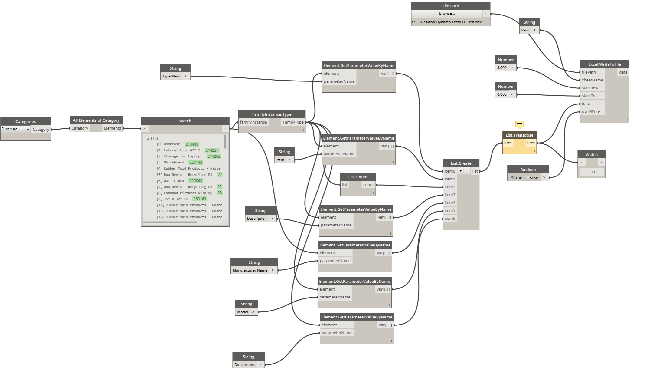

count is not a parameter, you need a NODE called COUNT below as an example on how you can do this, there are of course couple of ways to do this.
For the manufacture name should just be manufacturer instead? see below.
let me know if this works.

@4bimferdie.espiritu I was unable to find the node âList.CountOccurencesâ but found a node called âList.Countâ. I tried running the script with that but came up with an error on the List.Transpose which said "List.Transpose operation failed. Unable to cast object of type âSystem.Int32â to type âSystem.CollectionsIListâ.
@Jonathan_Roy I tried @Marcel_Rijsmus suggestion and the count still showed up as a blank excel column
and the Manufacturer Name showed up in excel saying âElementâ in the column@4bimferdie.espiritu in reply to your comment about the Manufacturer Name:
I made a instance parameter called âManufacturer Nameâ that is linked to a schedule which automatically fills in the Manufacturer Address. When I set this up (years ago) I was only able to do it as in instance parameter. I have not revisited using it as a type parameter recently but it may be something to look into. But that is the reasoning for not using the âManufacturerâ parameter already loaded into the family type.

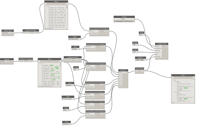

@Marcel_Rijsmus I have been using the âCatagoriesâ to âAll Elements of Categoryâ to get the type parameters successfully into excel. Though this was not your direct solution, I tried using the âElement Typesâ to âAll Elements of Typeâ to get the instance parameter and it showed up as a blank column in excel.
@Jonathan_Roy Have you had any luck isolating instance parameters. I have been able to work with type parameters fairly easily using something similar to yours. It is the instance parameters that are throwing me for a loop.

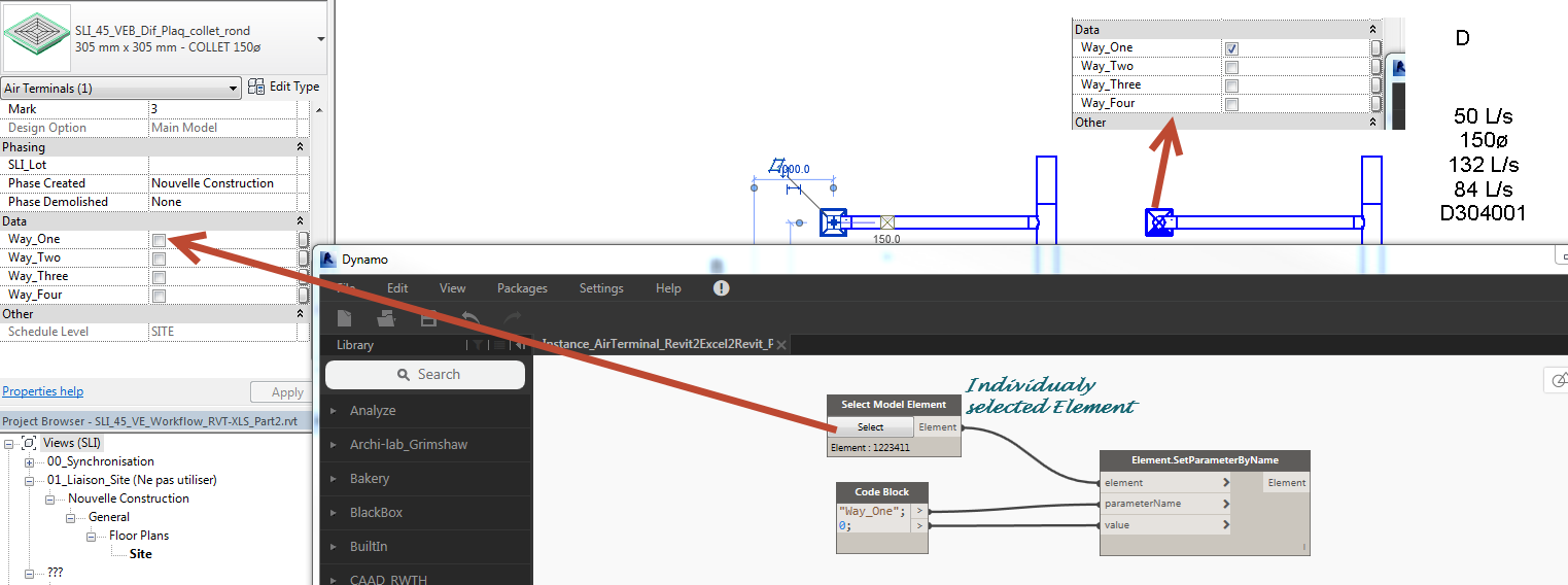

@abutterfield I hope Iâm in the direction your looking for!
-Changing the Instance parameter in all Type families
-Changing the instance parameter in one selected family
- Demo

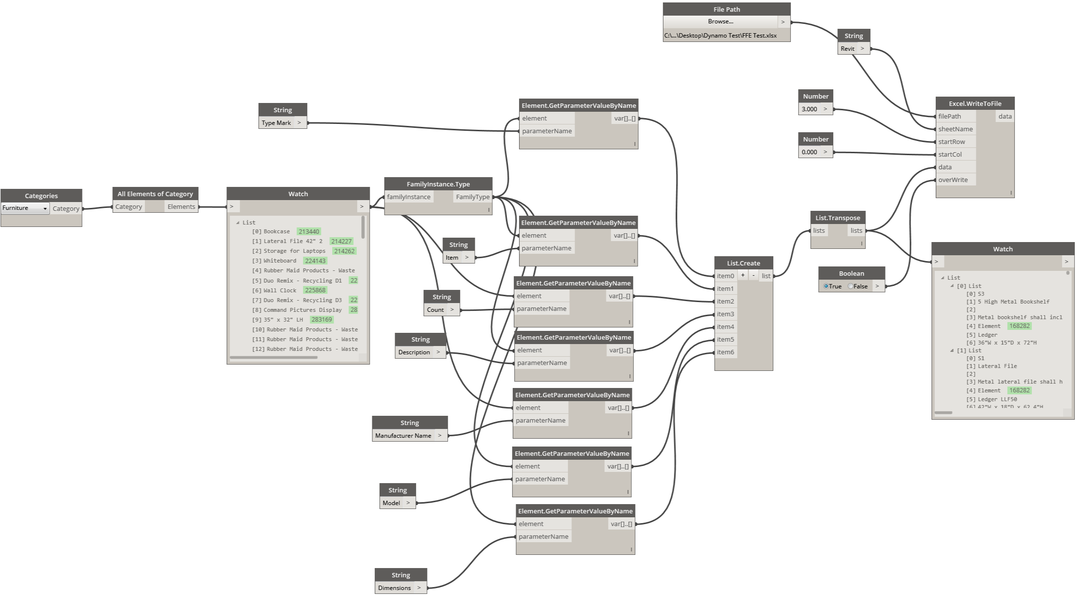

HiâŚi think what you trying to do is your mixing count with list. This is not possible on your current setup. First you need to decide.
A. You get a list from revit to excel as what you are doing and from excel you do the counting.
B. You get a list Count of all furniture to excel, like a total count.
C. Export a schedule to excel (not via dynamo)
To explain further you trying to feed count to a list of dimension, manufacturer etc. which are string/text in format.
You just need to choose A or B. I forgot the package where i got the countoccurances node. I will post it tomorrow so you can download it.
Hope this will help.
@4bimferdie.espiritu I currently have it set up at Opt C. But this is only a one way feed (Revit to Excel) and my end goal is to be able to make changes (not to the quantities) in excel and be able to feed it back to Revit and vice versa. Opt B would not work because I need a count of each item and not a total of the furniture. Would option A be a manual counting or would it be automatic? Are you also saying there is no way for Dynamo to get the quantities of an item and push that data into a designated excel cell?
