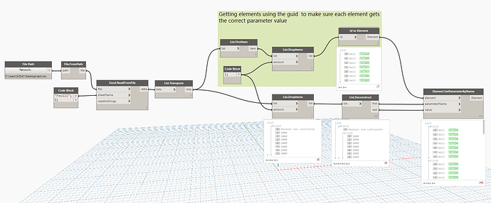

here’s a little example using 99.99% ootb nodes:

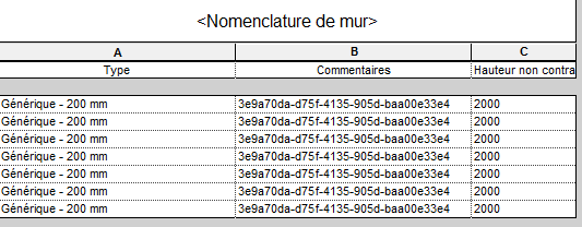

I extract the same data as the schedule and make sure to get guid of elements :
here’s the result in excel:

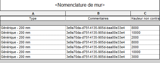

I change the values I want in excel:
Then back to revit (id to element is from Archi lab package) :
the schedule shows the modifications:

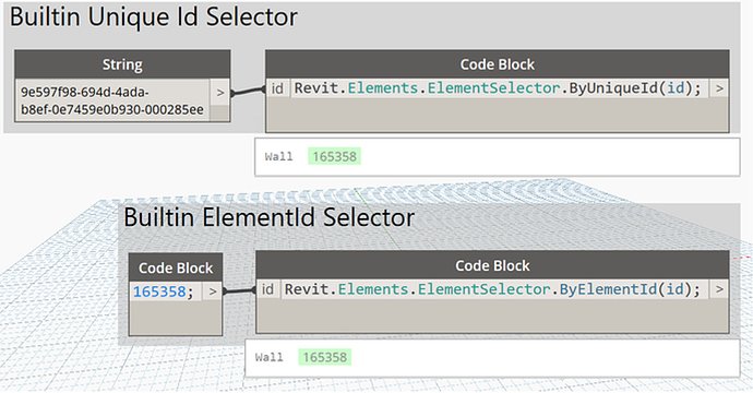

but Id.ToElement can be replace by:
Thanks.

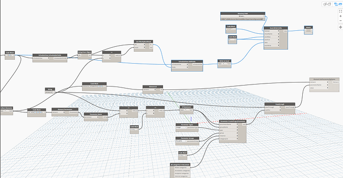

I am trying to figure out your script for importing back into revit. the exporting one is working, but the importing one I’m having issues with. See below: any suggestions ?
Ok go it to run without any errors but it is not changing the data in the revit schedule just in the excel spreadsheet ???

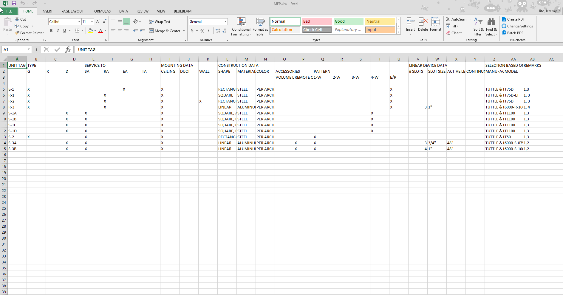

Did you use export script before importing ! please show snapshots for the excel file and which parameter you are trying to change

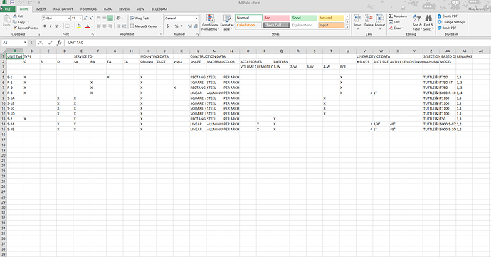

Yes I did run the export prior to the import
I would like to be able to change anything from column 4 down - and then import it back into revit with changes made but everytime i go to import it; it just run the excel and doesn’t change in revit.
