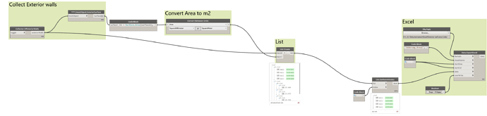

Im trying to export a list of exterior walls to excel but when i run the script i only get the data from the first wall
Can anyone please help?

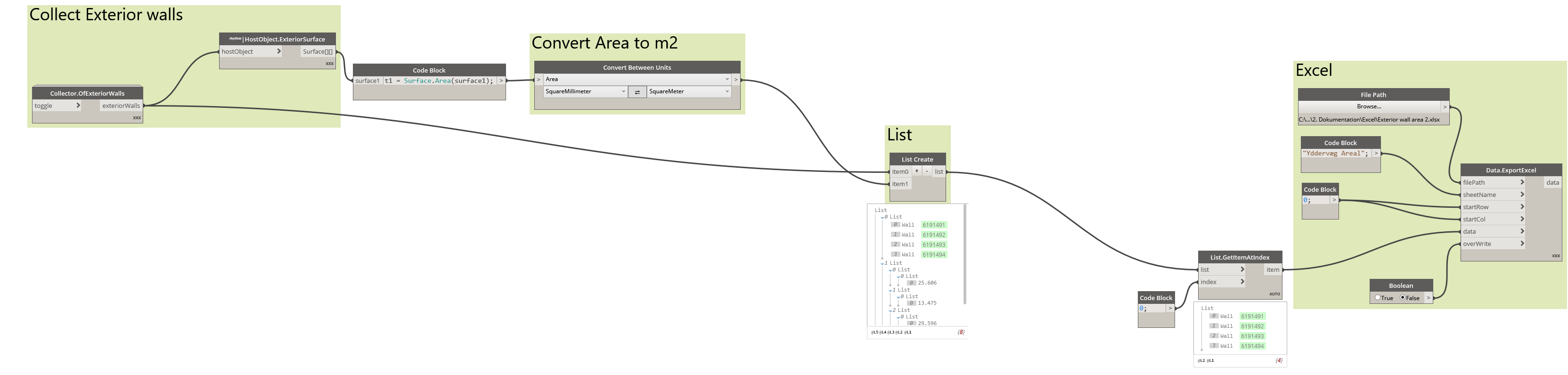

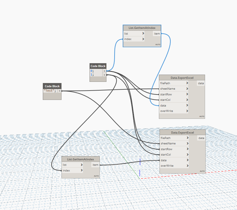

Create a new List.GetItemAtIndex with “1” and a new export to excel with new colomn “1”
You exportet only wall not values.
End should be like that
Lacing auto
Can you add a “List.Flatten” after ListGetItemAtIndex of Areas?
how do i add wall ID to the list?
With Element.Id you can create a new list and export to a column.
