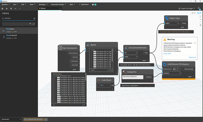

Hello , why this error apears even the input type is a link instance
Hello @Mariam.EmadFWSU3 is that the archilab node ? be sure you have the right version, it shouldnt give an autodesk.revit.db.revitlink instance…does it work if you just use OOTB ?
