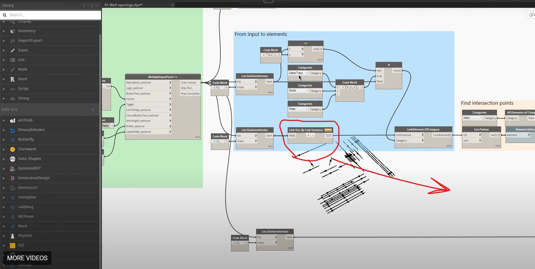

this is the script I’m following from a tutorial by @nenad.kovacevicSZH9A , but I can’t find the Node in the circle. (Link Doc By Link Instance )
Appreciate the help
Appreciate the help
That’s a renamed python node. The tutorial is likely the only place that would have documentation around what’s inside that specific node, however, the name indicates it’s just getting the Document from the selected LinkInstance which should be easy to recreate.
Look for some replacement options are check out the API if you want to write your own.
