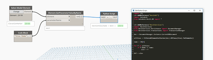

Hi @Vo_Minh_Doan
Hi Kulkul,
Thanks for your help. I tried your script but the problem is the script can not get the “View Name” in case of multiple views on one ElevationMarker. In that case, the ViewName return empty.
ViewNameReturnNoThing
However, I already found the solution. Firstly, I extracted the WorksetName of ElevationMarker then I splitted the names to get the views that created from ElevationMarker. In this solution, we need to enable worksharing mode first.
I would like to share my script here.
FindElevationNames.dyn (5.7 KB)
