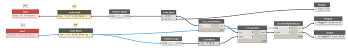

HI,
I like to use Element.IsTagged node but it shows error in custom node. Can anyone help me to correct this please.
HI,
I think you just need to update the code block as it says
DSCore.List.Flatten([item])
Remove the spaces and protected names from the inputs, then give them a type.
e.g. instead of
Tags of Category
use
tags: var[]..[]
Forgot about this tread but was able to get the node to work without warnings see below thanks @Hamish for the input.
I would like to do this node but for view specific. Any ideas??
You could collect all Elements visible in the View and then use this node
For this the Python code has to be modified. Something i can’t do.
