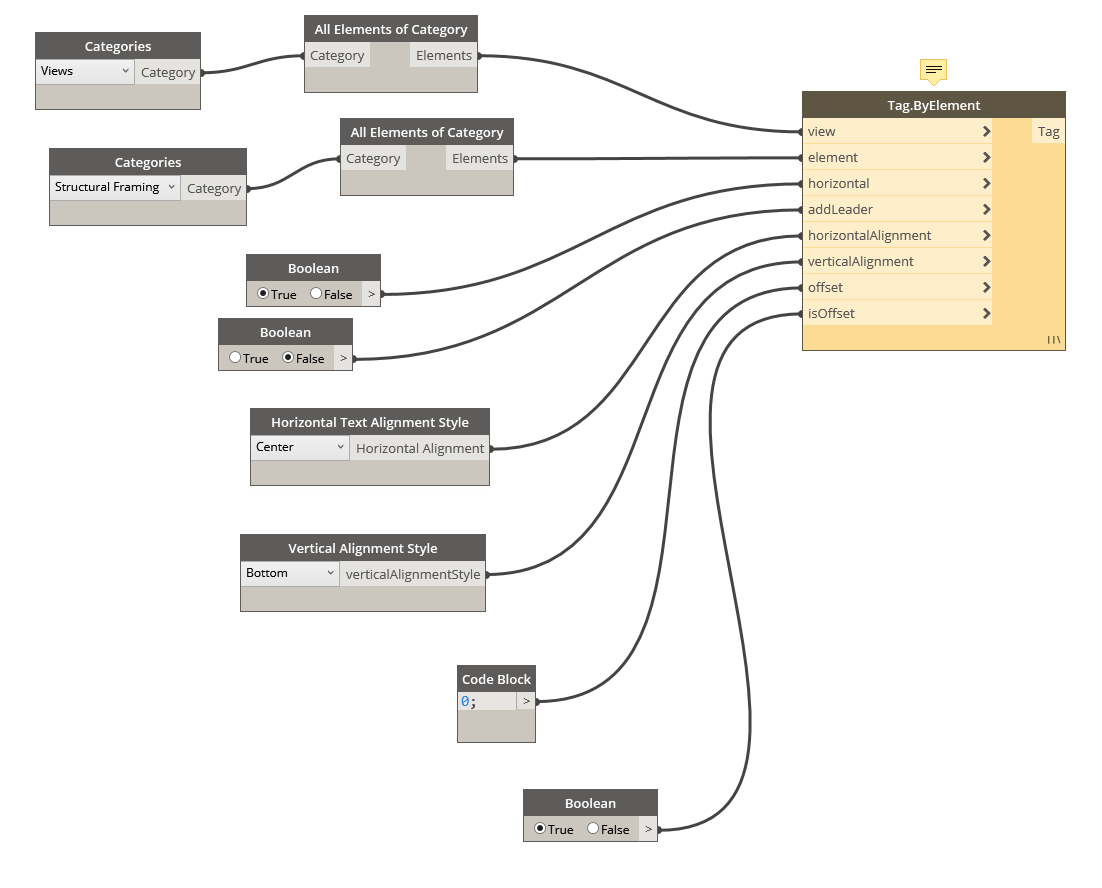

Tag By Element Doesn't work
I do not know why the script does not work, please check it engineer Ewan

You have to connect views and elements lists to code block β€œv” and β€œe”, where β€œv” is views and β€œe” is elements which you want to tag.

I tried but also does not work de
thank you very much, it works

you have no views while repeating the category twice
