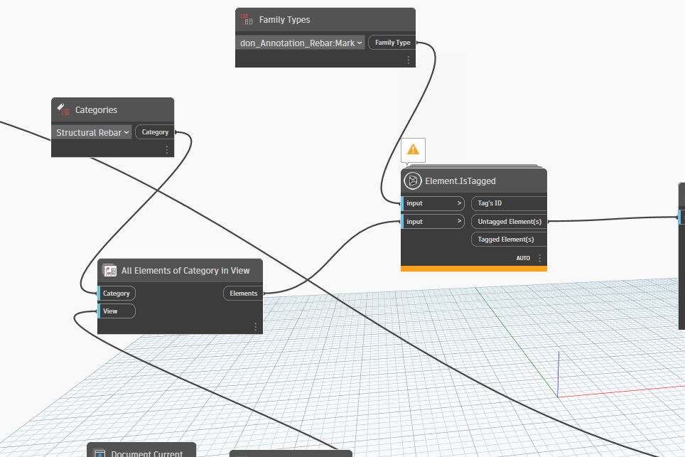

Hi all. I have this node but its not working

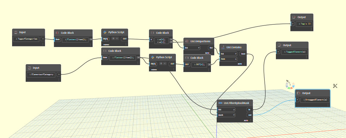

this is the edit
Hi @technitutors it looks like good old steamnodes…it havent been maintained for years, but should work if you edit the node as here…
can you tell me what needs to change here
Be sure you python engines is set to ironpython 2 and you have python 2.7 package installed…hope it help…or you could try this one here from genius loci
or OOTB
