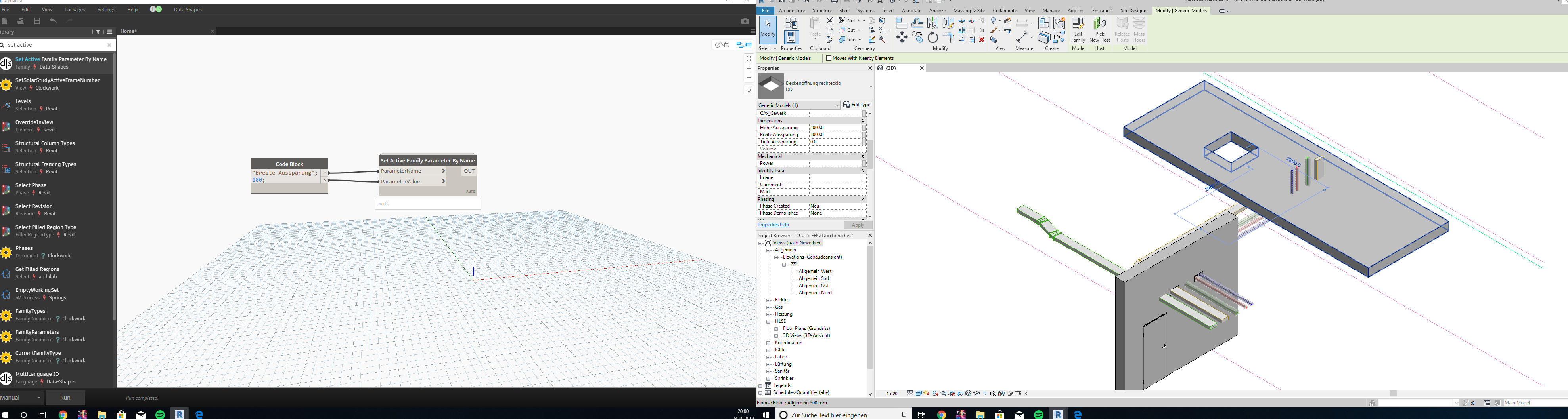

I want to edit a family size called ‘deckenoffnung rechteckig’. In order to edit the Height and Width of this family i have to put the family into the revit model first, but i dont want that. What I have in mind, I want to edit this family properties straight away from dynamo.
p/s : Yes i can edit it manually in Revit, but in term of curiousity. Is it possible to edit straight away from dynamo and use it for the other purpose.
As you see the result of this, the family default size (blue colour) is huge. I want to achieve the size (red colour) without placing the family first in revit. I want to change it directly from dynamo.
@Eeins That node from spring nodes returns the family instance. You can use a setParameterValueByName node on it to set the family instances height/width after it’s placed
