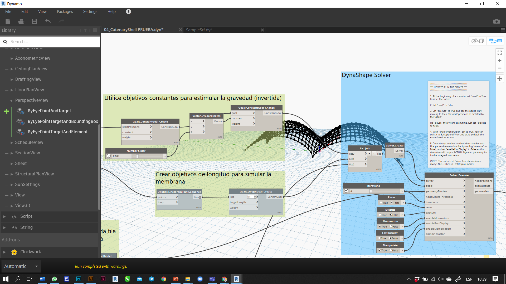

Hi, Can you help me?
I’m using Dynashape packge, but when I create a geometry, I don´t know how do I put this geometry in my revit. There isn’t when I look my revit. I need this geometry to create a roof but I can´t do
