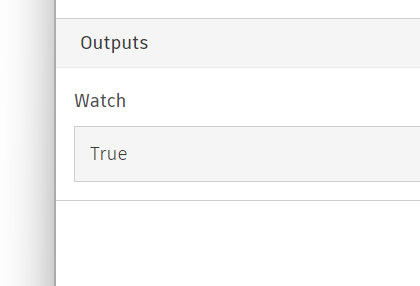

Try adding an output, even if just a watch node returning ‘true’, as there was a bug in a Dynamo for Revit release which prevents execution in some cases. Once added if the issue gets fixed I believe that you can remove it.
Hi Jacob ,
tried to add it but still failing
Regards
