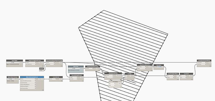

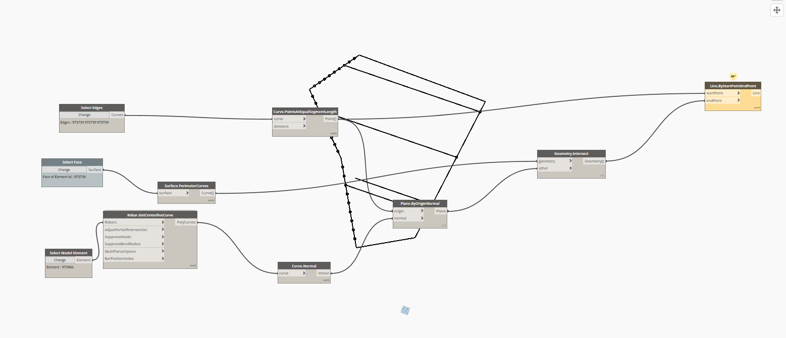

Dynamo.Intersect returns less than it should. Can some one help?
I want to create straight rebars that is cutted to my geometry. I am doing this by joining lines. First by picking a surface then picking lines that I want it to follow. The start of my script is not working as it should only partly. I am creating points on the other side of my picked edges by using planes and geometry.intersect. The geometry intersect. gets a input of 27 points but only returns 6. I have tried long lacing without success.
Can some body help?
Dynotest.rvt (1.3 MB) Rettejermtest.dyn (19.1 KB)

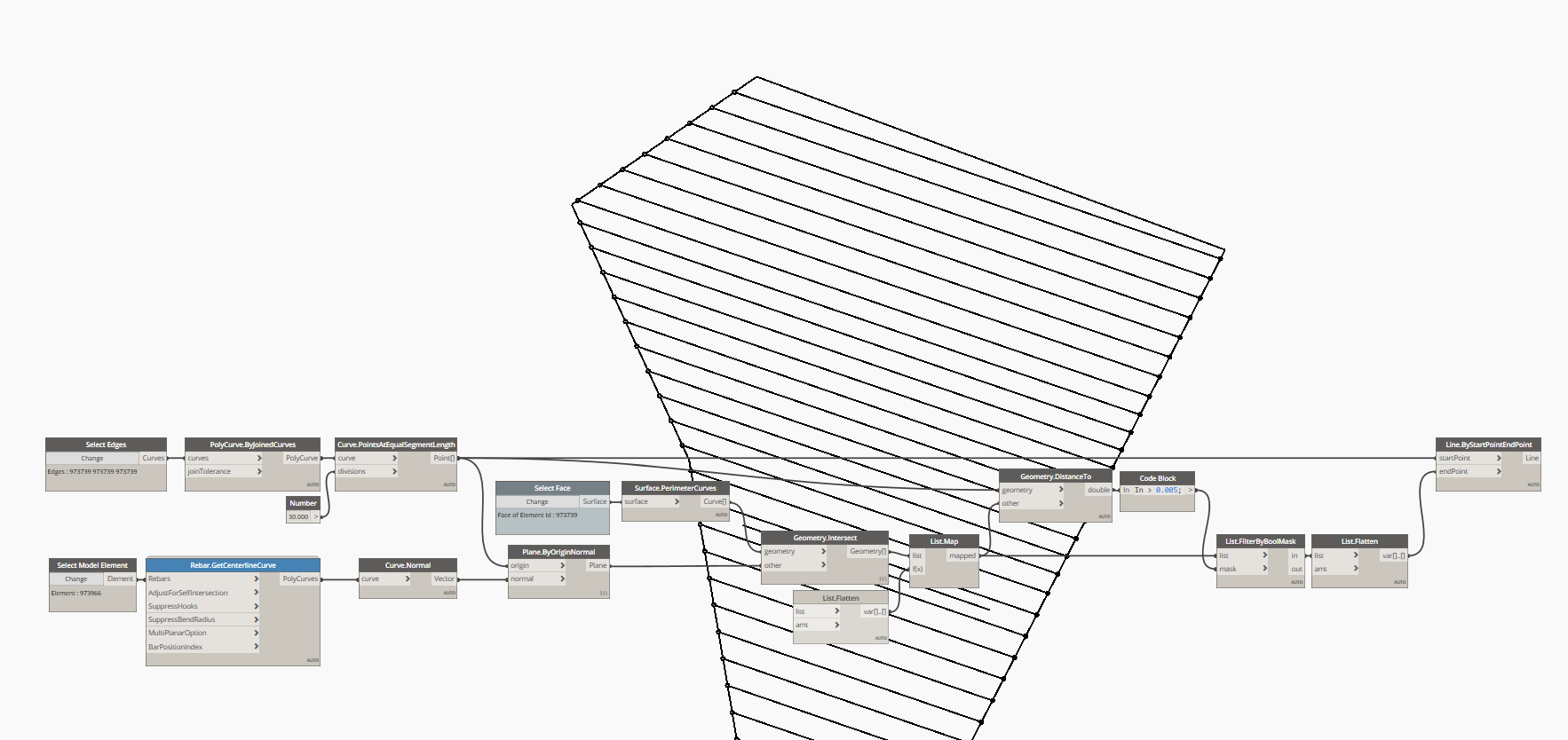

Rettejermtest2.dyn (32.9 KB) Hi @mathia1510,
I made some minor changes and created a filter, now i get a fully working result :slight_smile:
Thank you so much Daan! Very kind! Clever way to filter the list. Will remember that to next time!
