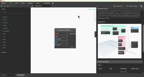

Dynamo for Civil 3D 2026.1
Hey Civil 3D users,
Civil 3D 2026.1 was just released! :rocket:
You now have access to Dynamo Core 3.5, as well as a ton of improved documentation for all the nodes in the Civil 3D section of the library. Here’s a blog post that summarizes everything for you :backhand_index_pointing_down:
