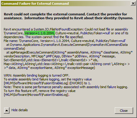

With this error:
How do I get Dynamo running again?

Initially I had multiple versions of Dynamo Installed. After reading your post, I uninstalled every single one. Then Reinstalled the last I had downloaded yesterday - “DynamoInstall1.1.1.20160804T1248.exe”. Then I restarted again. This is what I have currently installed:
But still having the exact same issue, with the exact same error popping up.

Thanks for the reply. It appears the installer for Aug 4th build has deleted (or modified) something critical. Because I tried rolling back, going backwards through several different builds - all of which have worked in the past, till I installed the build from Aug 4. Now, no matter how much back I go, I get the same error, just with a different build number in it. Please help! I am completely unable to use Dynamo in Revit 2015, 2016, and 2017.

It looks like Dynamo Core is not properly installed. Can you please check if DynamoCore.dll is available at C:\Program Files\Dynamo\Dynamo Core\1.1\
If it’s not there, I’ll suggest that you first uninstall DynamoCore and clean up the Dynamo Core installation folder and then install the stable build of Dynamo 1.1
If DynamoCore.dll is available then you may try launching DynamoSandbox.exe from C:\Program Files\Dynamo\Dynamo Revit\1.1
If DynamoSandbox.exe runs fine, then we need to check if any of the Revit dependencies are creating any issue.
