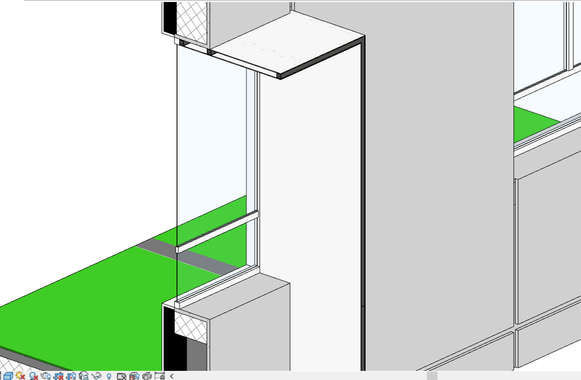

Any free form API nodes available in the experimental section? :slight_smile:
Hello @Marcel_Rijsmus - For Dynamo 2.13 only the T-Splines nodes exist in the experimental section.
What kind of free form nodes would you be seeking? How would they look? Behave? What results would they return?
@solamour
bending mulions
Revit interaction nodes would need to be a big dynamo for Revit push, not a Dynamo core push. Not saying it can’t be done, but it’d be best raised with that team rather than the Dynamo core team (what this topic around Dynamo 2.13 is about).
I will also note that producing a robust enough system to cover all the features and combinations of use cases which this opens up bring a LOT of complexity with it; that complexity leads to issues of it’s own. A fully robust system would require something like 150-200 nodes by my initial estimates. The Synthesize Toolkit package from @Karam_Baki does a very good job navigating some of those issues and has some awesome nodes for this type of work - worth a look for anyone who isn’t familiar.

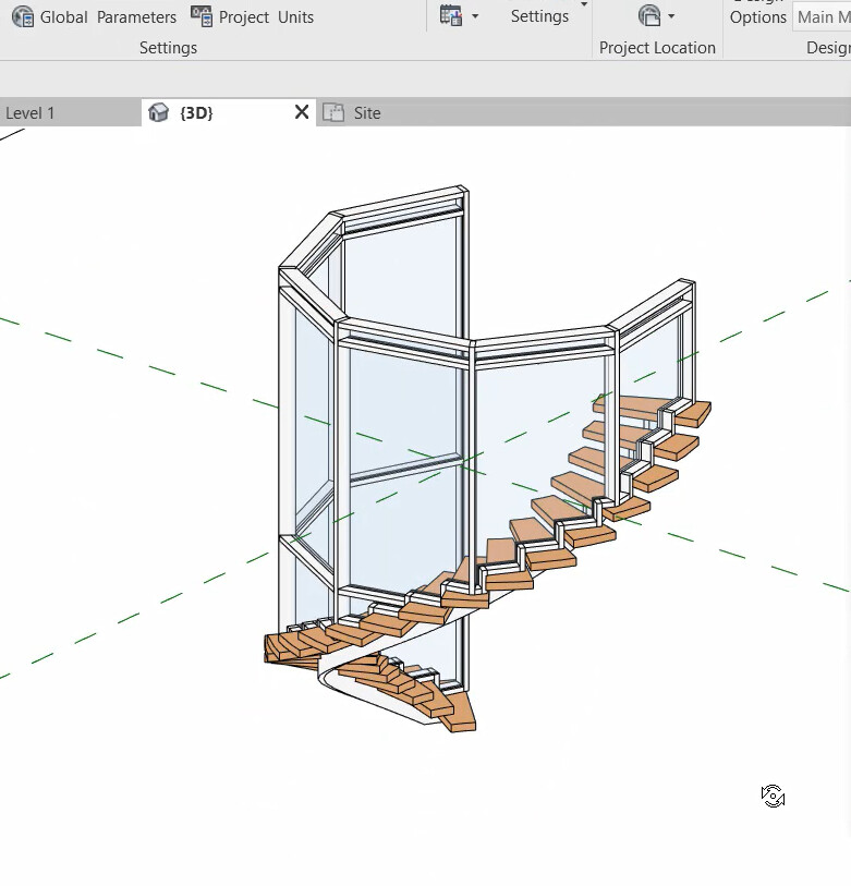

And for anyone willing to dive into this, there are 2 main nodes to handle Dynamo to Revit geometry
-K-Family Insert
It gets your geometry into Revit as a family, and it has vast variety of options to alter.
Subcategories, Materials, Is Void or not, …etc
-Dynamo Geometry To Revit Compatibility
It does exactly as the above, but the geometry you’ll get could be a FreeForm or ImportInstance, and it also have lots of other options to alter.
The defaults of both of the above is good enough, you can simply plug in your Geometry, (or SAT file) it understands both.
Also, it works differently based on Revit version, as it harnesses the best of each version, and is continuously improving in each alteration of ShapeImporter Class
Finally, it can also bring some “illegal” stuff, like Loaded Roof, yeah you heard it, a Loaded Roof that you can use to attach your walls with.
You may also use it to mess with other stuff, like converting a whole stairs into Roof, so you may attach your building elements on it.
And if you’re willing to dive deeper, you can also bring Loaded Walls, and parameterize it then load it into a Window that can perform section auto wrapping and other nasty details that are needed for construction projects.

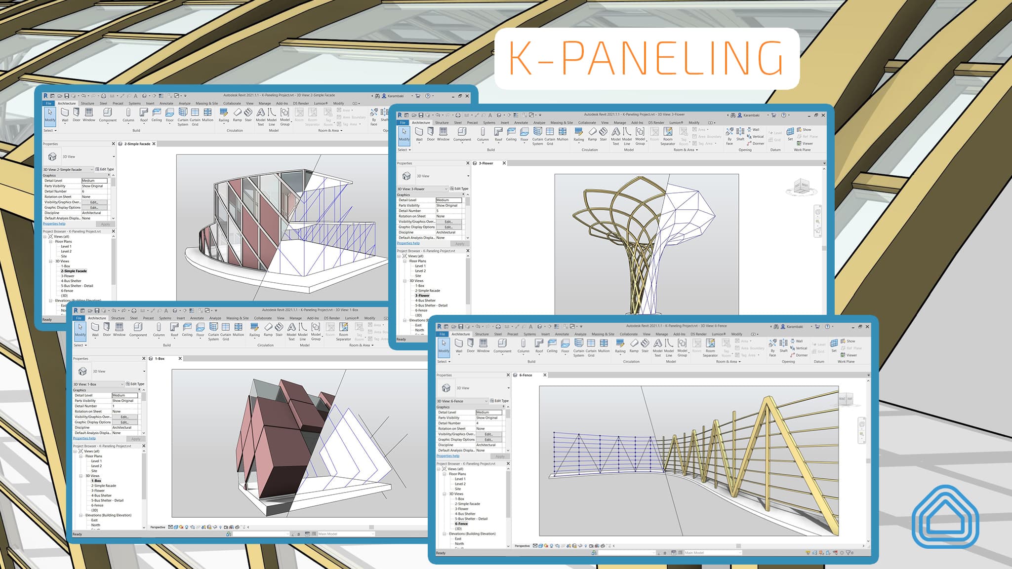

As for @Marcel_Rijsmus image for bending mullions, well it was a result of an extremely complex geometry handling via another set of nodes, called K-Paneling
You may also find and use them in the extra folder of the toolkit:
-Family.K-Paneling Data Import
-Family.K-Paneling Frame
-Family.K-Paneling Glazed By Intersects
-Family.K-Paneling Glazed By Voronoi
-Family.K-Paneling Solid By Intersects
-Family.K-Paneling Solid By Voronoi
-FormIt.K-Paneling Frame
-FormIt.K-Paneling Glazed By Voronoi
-FormIt.K-Paneling Solid By Voronoi

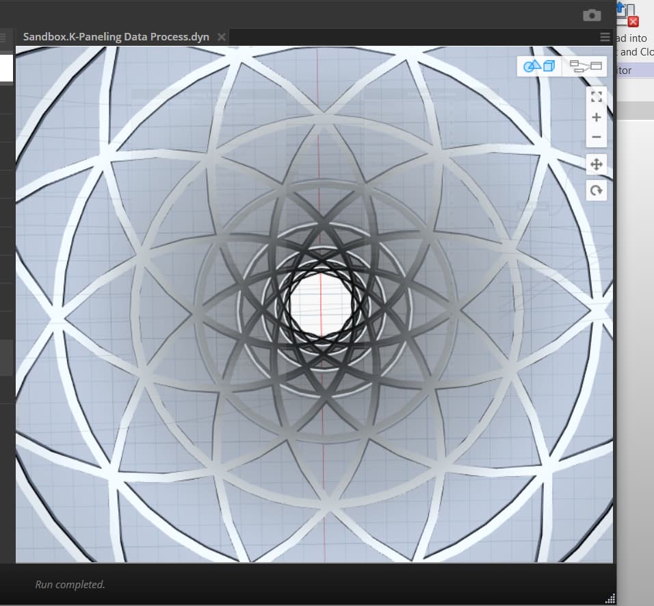

-Sandbox.K-Paneling Data Process
They also work with formIt
And Sandbox Dynamo, (But not the latest 2.13 yet, as I have to run through the headache of Python 3)
Hope all the above could help someone who’s struggling with such issues.

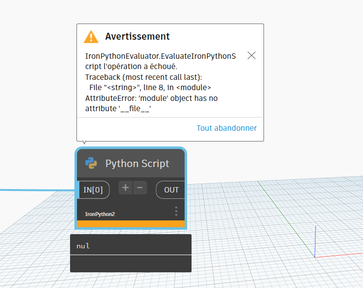

Well, in the meantime you may install DynamoIronPython2.7 package that allows the support of old Python nodes that were created with IronPython2
Although I noticed some changes in the evaluator of that package refusing to execute some of the nodes even written in IronPython2, especially with the ones that have extremely complex functions…
But good news is that they could be fixed like within a minute when an error is detected.
Also, it varies from package to a package, some are using Zerotouch nodes written in C#, which will have the least impact on these changes (Except for changes in Revit API itself, such as the infamous Units API change), but one thing is for sure now, no more support to Revit 2018 with Dynamo 1.3, at least in Synthesize package.
Hope that helps bringing some ease when upgrading.

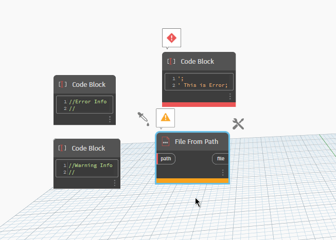

Warning texts are no longer selectable, is there a way to copy the error message ?
@c.poupin
You can use this simple utility:
https://ramensoftware.com/textify
Thank you for this software.

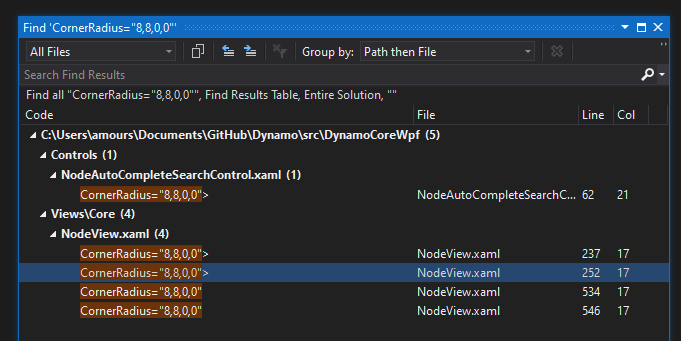

@sniken - If you search for CornerRadius="8,8,0,0" in the XAML files above, you’ll find the Node corner radii. You can simply remove this entire line in the XAML and it will revert back to square corners.
Note: Other parts may have a different radius - i.e. custom node layered folder rounding is CornerRadius="6,6,0,0".
The most comprehensive way to achieve the result you are looking for is to create a custom branch that reverts the nodal UI changes, then update that against the Master build every time we release. Depending on your skill level, this may be a lot of work :pray:
If this is your preferred path, then search the commit history of @oliver.green , Pull requests · DynamoDS/Dynamo · GitHub, which includes all of the Node changes (Note - there is lots of other stuff in there too).
