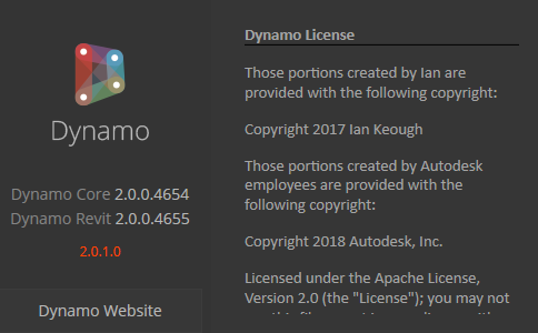

Is Dynamo 2.0 very slow or is just happening to me? Has anyone else noticed this?
