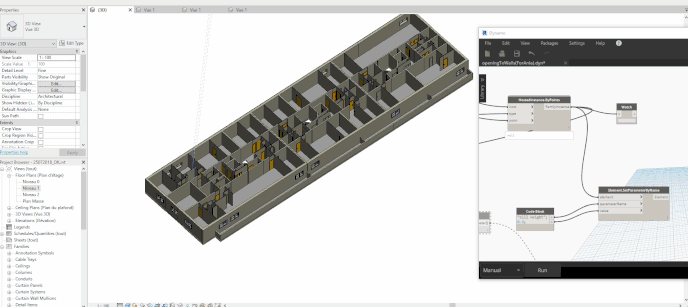

I’m trying to put doors automatically into existing walls. I have an excel file with insertions points of the doors and its dimentions (length and width). The location and dimansions of doors are generated correctly bu they are not cutting the walls!! Can any one help me with this ??
Yes. It does.
I think the problem is that I create new family type with new parameters but not all the parameters are copied from the base family (like analystic construction,…) to the new family type. May be some parameters are locked!
