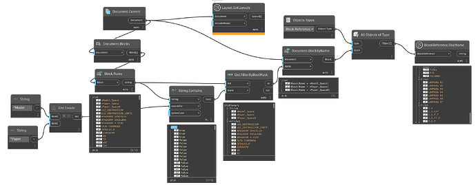

Amigo @qnliebbe buenas. this is how you can filter the blocks or elements present in each layout, with the Camber package you can get the UI name of the layout (actually it gives me an error don’t notice), note the RealName node is in the OpenMep package for C3D.
