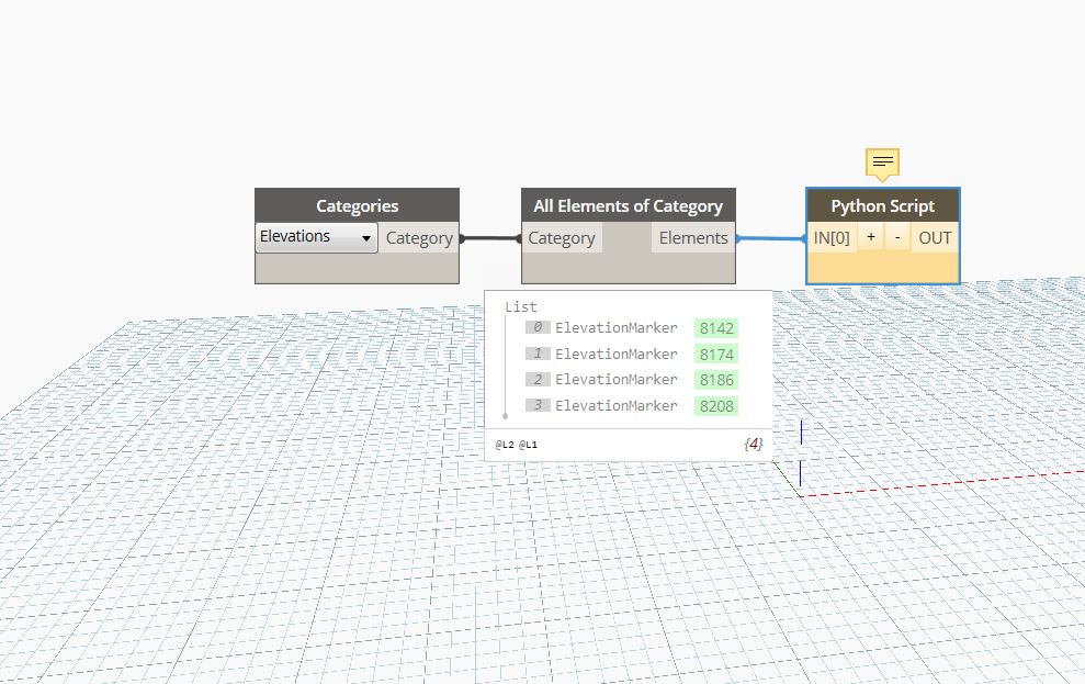

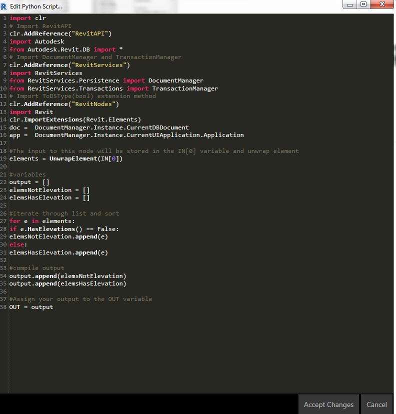

I am trying to delete unused elevations first then delete unused sections
I followed this link and it deletes all of the elevations not just the unused. (placed on sheets) The code seems correct but I must be missing something
Thanks in advanceHome.dyn (7.0 KB)
If I am stuck on the Elevations then the Sections will be worse. Thanks as always in advance

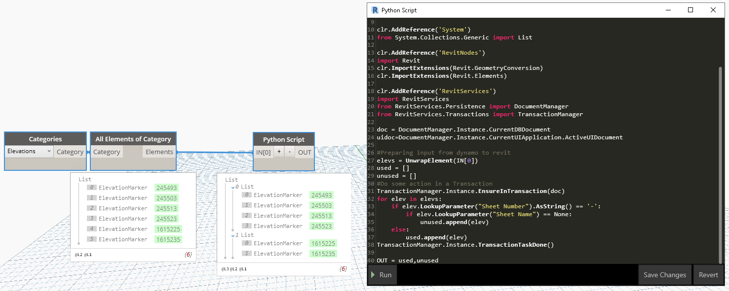

You should check the two Parameters associated with a view being on a sheet.
Edit: Not sure why the BIP aren’t working correctly, but they kept giving me NonType errors so I resorted to LookupParameter in stead. This however gives different results for the two different parameters if they are “null” or None.
If either of these have a value then it is placed.

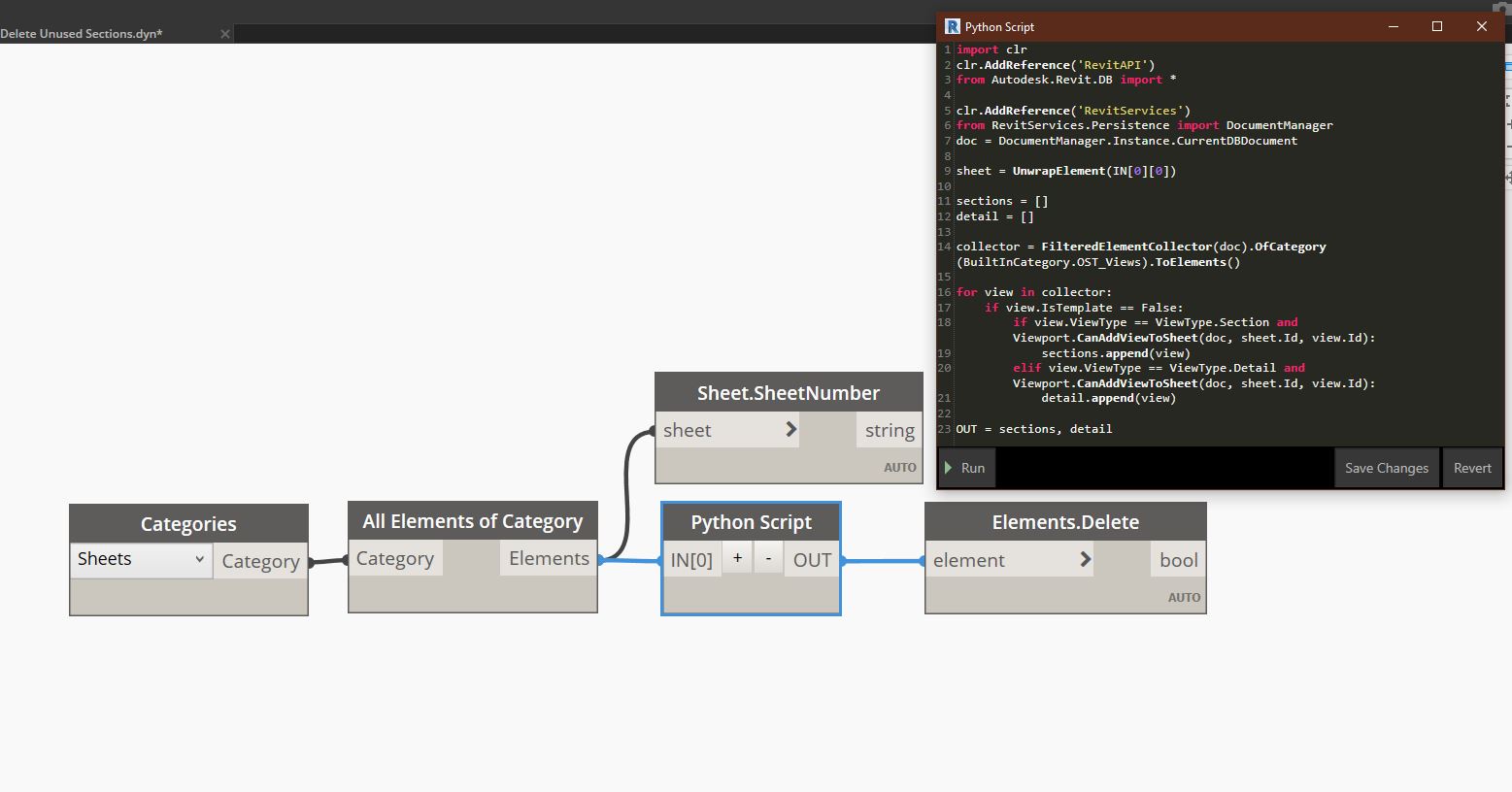

I keep trying to make it delete sections in the same way but keep getting errors. I guess sections are different than elevations.
OK went in another direction and got it to work here is my solution. I had to add in another one for callouts because revit even though it is a section it is for a detail view not section lol
I could also add in elevations to the python as well and do a 1 stop shop lol
