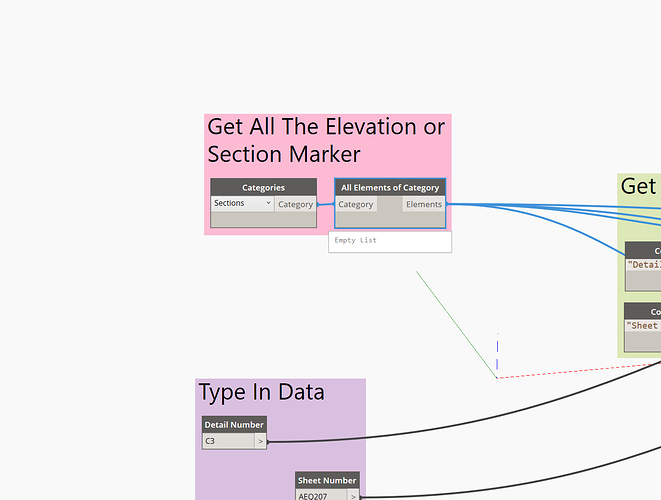

I was trying to set up an elevation and section marker seeker. When I change the Catergories node from Elevations to Sections, it returns “Empty List”. I am pretty sure there is section view in the project. I also have it tested in the Revit Sample project. The node returns “Empty List” as well. Is it a bug? If not, can someone help me with how to select all the Elevation or Section markers?

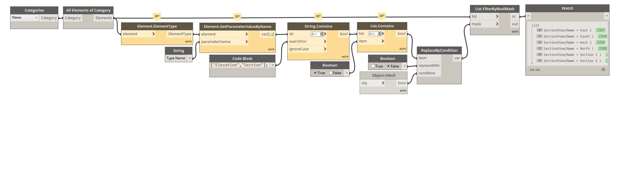

This is indeed an unusual thing. If I try to find the section by it’s ElementId and get it’s category that way it shows up as a view.
I can get the elementId of the section line/marker using the following pythonscript.
(I put this directly after the ‘All Elements of Category’ node. The script requires 2 inputs. The first one being the elements, the second one being the index of the view you want the marker of.

navermind, I checked the Revit API, there is an “elevationmarker” but nothing under the “sectionmarker”
