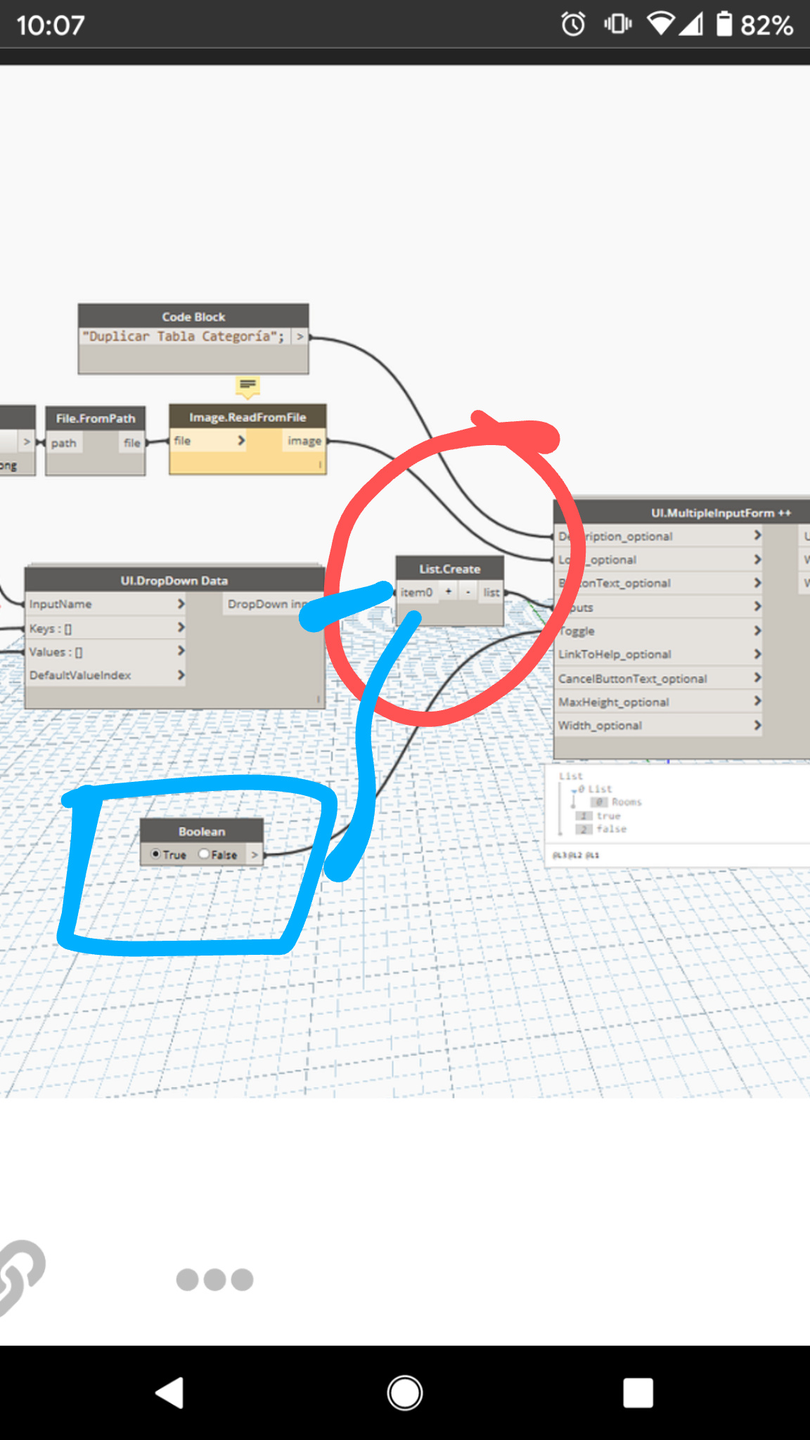

Try adding a List.Create to collect the values being used in the Inputs input.
Like this. All of the input need to feed the List.Create node.

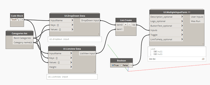

Here is the result when i add the node List.Create:
The result is the same: all “null” values as outputs and the pop-up window doesn’t show up… :frowning:

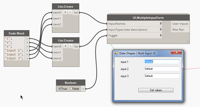

Instead, the simple “UI.MultipleInputForm” of the same package works very well:
I don’t know what i am doing wrong :frowning:
