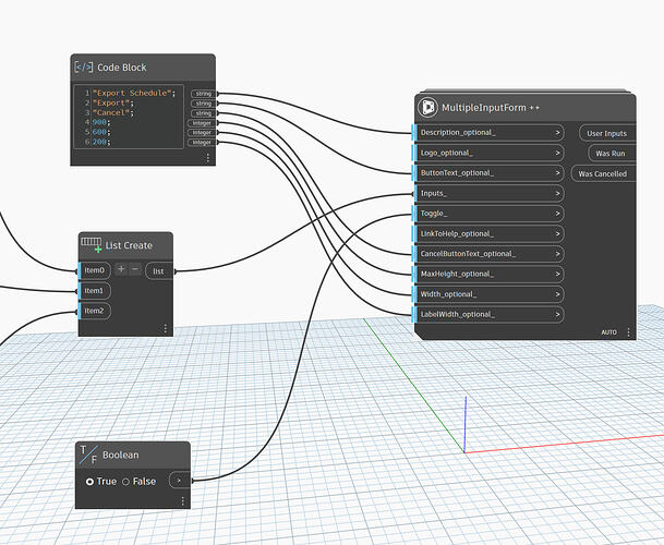

Data-shape User Interface not showing in Dynamo for Revit 3.6.1
User Interphase using Data-Shapes does not pop up, can someone help me navigate the reason?
Using Revit 2026, Dynamo Version 3.6.1, and Data-Shape 2026.4.2
Are there any other packages that I should have to make it work?
What isn’t working?
The User Interphase box does not pop up, refer to the picture below
Troubleshooting is likely going to require the graph - post it and I’ll try and have a look.
I believe the issue is with the versions and not the graph. I have tried the same graph using Revit 2024, Dynamo 2.19.3, Data-shapes 2024.2.114, and DynamoIronPython2.7 version 2.5 and it works (the user interface pops up when I run it).
Not sure what versions are required for Revit 2026 to make the user interface pop up. I saw a post saying that DynamoIronPython is not required anymore for the latest version of Data-shapes.
