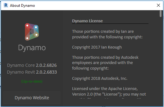

I’m Using the newest version of Dynamo:

It reproduces for me but on the initial ‘all elements in view’ node. Wondering if this is Revit version related - @L.Cunningham can you confirm your Revit build?
@jacob.small I’m currently using Revit 2018.
On both systems or just one of them? This appears to be a screenshot of the go to market build of Revit 2018 - meaning that you’re missing about 2 years of updates, patches, and fixes. Definitely want to get those installed as it could very well be the cause (on either or both systems). Build lists (omitting the first ship build) can be found here: Autodesk Revit 2018 Product Updates
