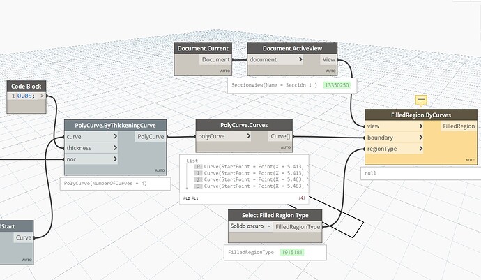

I am trying to create a filled region… what is the problem… I have tried to follow the steps in another post and I can’t find the error…?

I’m not sure but i think the node need a boundingbox as input? What does the node ask?
Did you try to use transaction end?
O btw you level list is not the same, try to use longest or set them to the same level
apparently the lines must be oriented in relation to the view in which it is located…
Example…
If the current view is a section then the lines must be in that view plane… but in my case… I am in the section view but my lines are like in a plan view… I have to do multiple movements to be able to locate them according to my view…
Do you know of any node that takes my lines and puts them on a plane?
