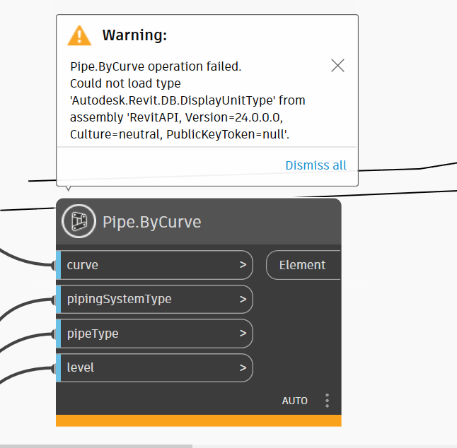

I did already create pipes by curves on Revit 2022 but i used (Pipe.ByCurve) from Univeso_BIM package.
It seems clear that, due to the lack of updates for this package, the nodes may not work properly with the new version of Dynamo.
So, is there any new nodes or packages that I can replace it with them to create the pipes by curves?
Thank you
I believe that MEPover has nodes for this, and that the package has been updated for modern builds. OpenMEP might also work but that has it’s own installer.

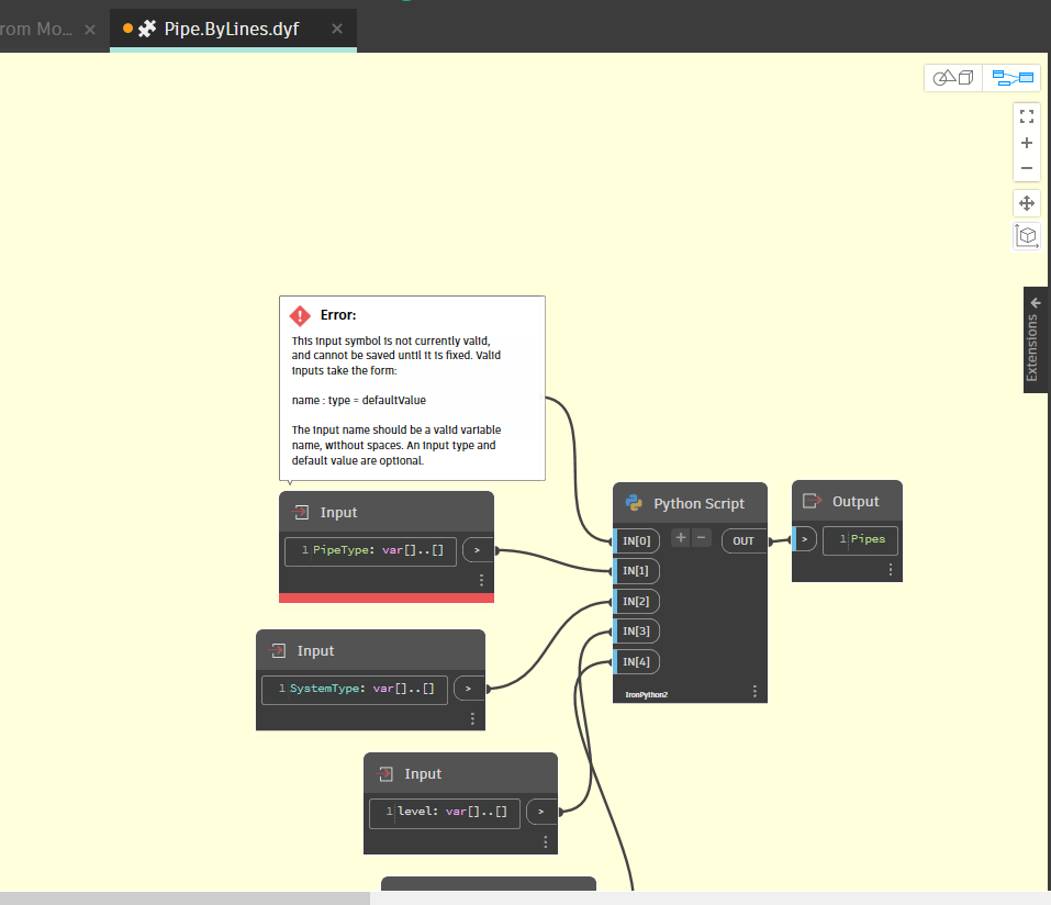

but in pipes by lines i have some issues like shown below, what does that mean?
Change the first letter of Pipe and System to lower case.
Thank you
