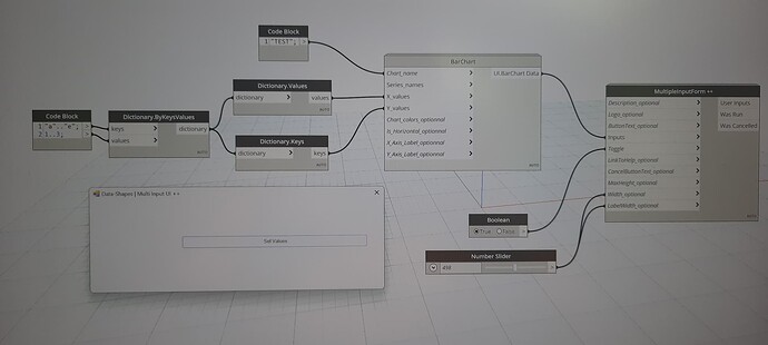

Hello , does anyone know what the problem of this simple script is? “UI.MULTIPLEIMPUTFORM++” works with other nodes but not with the charts.

Your screenshot is mostly illegible. Try again and make sure all the node titles are visible and that you have all node preview bubbles pinned.
That said, it looks like you’re missing an input for the chart node. Any input with a red bar means it’s a required input without a value.
it seems to me that the charts part of data_shapes is not yet compatible with Revit 2025 (.Net8)
I also tried with revit 2022.but still not working.
@faezeh.nikmandan
you forgot an input
