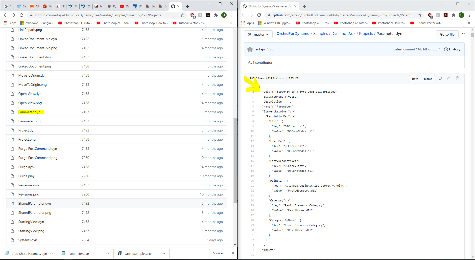

@tvaughn i tried to download the Orchid package, but it referred me to github website and asked me to download and exe file. I am on company computer, I cant install external exe file. Is there a way to go around this ? please help, Thanks!
The way to install should be quite clearly explained on github you can simply copy paste the files yourself :slight_smile:
@Jonathan.Olesen sorry I am new with all this and a bit slow. You mean copy this? i tried to copy all this in codeblock or pythonscript node in Dynamo but it doesn’t work. Also tried to right clicked on that dyn file and save as. Dynamo just couldnt open the file.
You need to copy the content of the zip folder to the dynamo folder on your computer :slight_smile:
