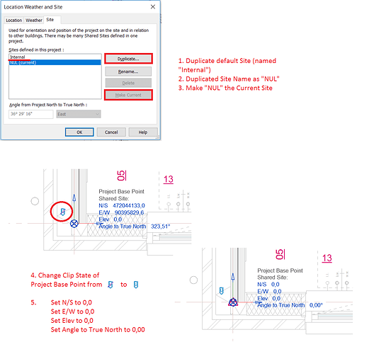

I am looking for a method to duplicate de Settings of the project Base point as an different Site location and Edit the New Locations Coordinates. The workflow in Revit looks like this:
I only found a way to set the settings of the project base point, but now how to duplicate it or to create a new one.

you have to Use Python for that.
I don’t have the knowledge to achieve that. Can you make such python script?
I was trying to get into base point and survey point and found this package from zkukoven.com, has two nodes for that purpose.
