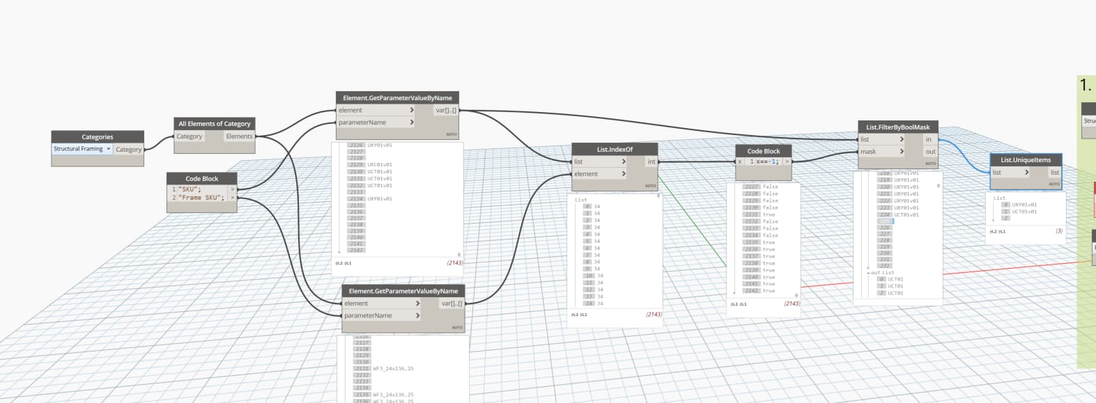

Hello! I have successfully created a script to create the schedule but all the SKUs are within the same schedule and I wanted each SKU to have their own schedule but I’m not too sure how to start that. I also want to get the SKU information from Revit so I don’t have to manually typed in the name of the those SKUs in the script and so I can apply this script to other revit files. Thanks!

This is the first step. You will need to generate a schedule for each sku, and a filter for each sky, and then apply the filter to the schedule.

You can use Dynamo to find all your - in this case - Structural Framing Families and use their
information to create the needed Schedules and the corresponding Filters.
This is what I have so far and I don’t feel right. I’m not sure where is the blank space coming from. I’m trying to filter out the matching indexes of the two parameters and then Im trying to get true indexes using filterbyboolmask. Could you take a look?

Sorry, Im just trying to seperate the two skus into two schedules because they are all now in the same schedule with my current script.
I don’t quite see why you’re pulling two parameter values - one for sku and one from frame sku; which is the parameter you want to filter by?
I actually don’t know, I was thinking to get two parameters to make sure I filter out the frames I want, but eventually I just want these two skus to be able to split into two schedules. I’m new to dynamo so some of my logic might not be logical.
