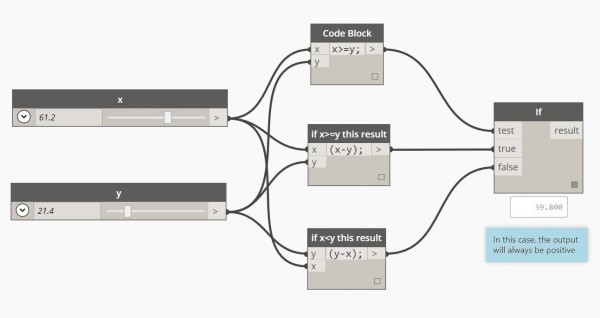

I would like to ask about “IF Node”. I have problem with connect two conditions
for example:
if x>=y than equation A
If x<y than equation B
like screen shows:
resalt from equation i want to put into family parameter.

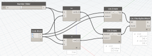

A method i’m pretty fond of is using a filterbyboolmask. Below I show two examples of output. “IN” is the result you want to tie to the family parameter.
A simple example
