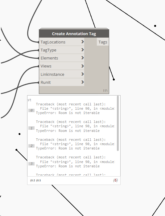

Try setting the lacing to longest in the Create Annotation Tag node.
When I set it to long i get this msg.
Hi @Graesborg,
I’m guessing your List.Create node is messing up the structure of your inputs.
This worked fine for me:
After reinstalling revit, because i had some problems with it, everything works fine with short lacing.
