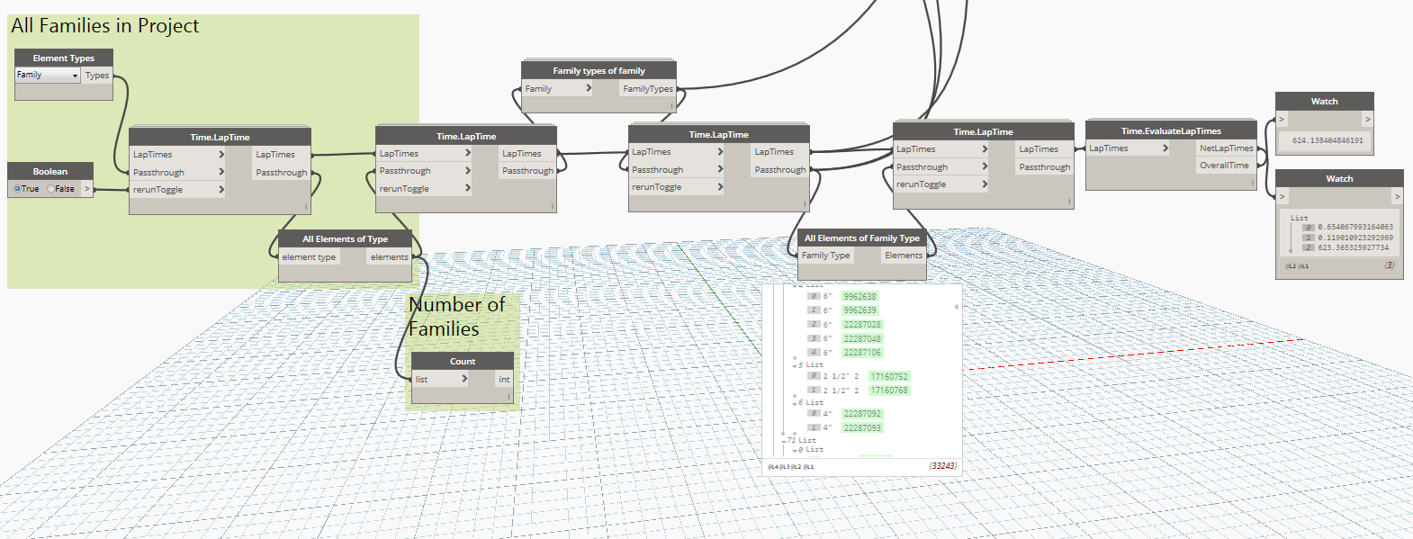

Do any of you have or know of a better way to count how many instances there are of all the project families? I am trying to figure out what our most used families are. I can get all of the placed elements but this takes forever and is not really needed. If you look at the graph below All Elements of Type and Family types of family take less than a second to cull there data but All elements of Family Type took about 10 minutes. I don’t actually need the Elements just want to know how many there are.

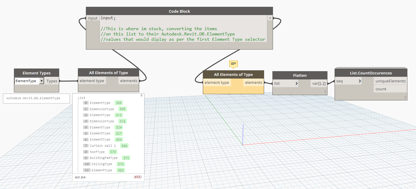

Do you know the equivalent of All Elements of Family Type in the API? I could not find anything.
What I was trying to achieve above was to collect all elements of the input elements category and then see if those element type matched the input element.
Or should I start by collecting all elements then getting the type then the family? This second way seems like it might be faster.

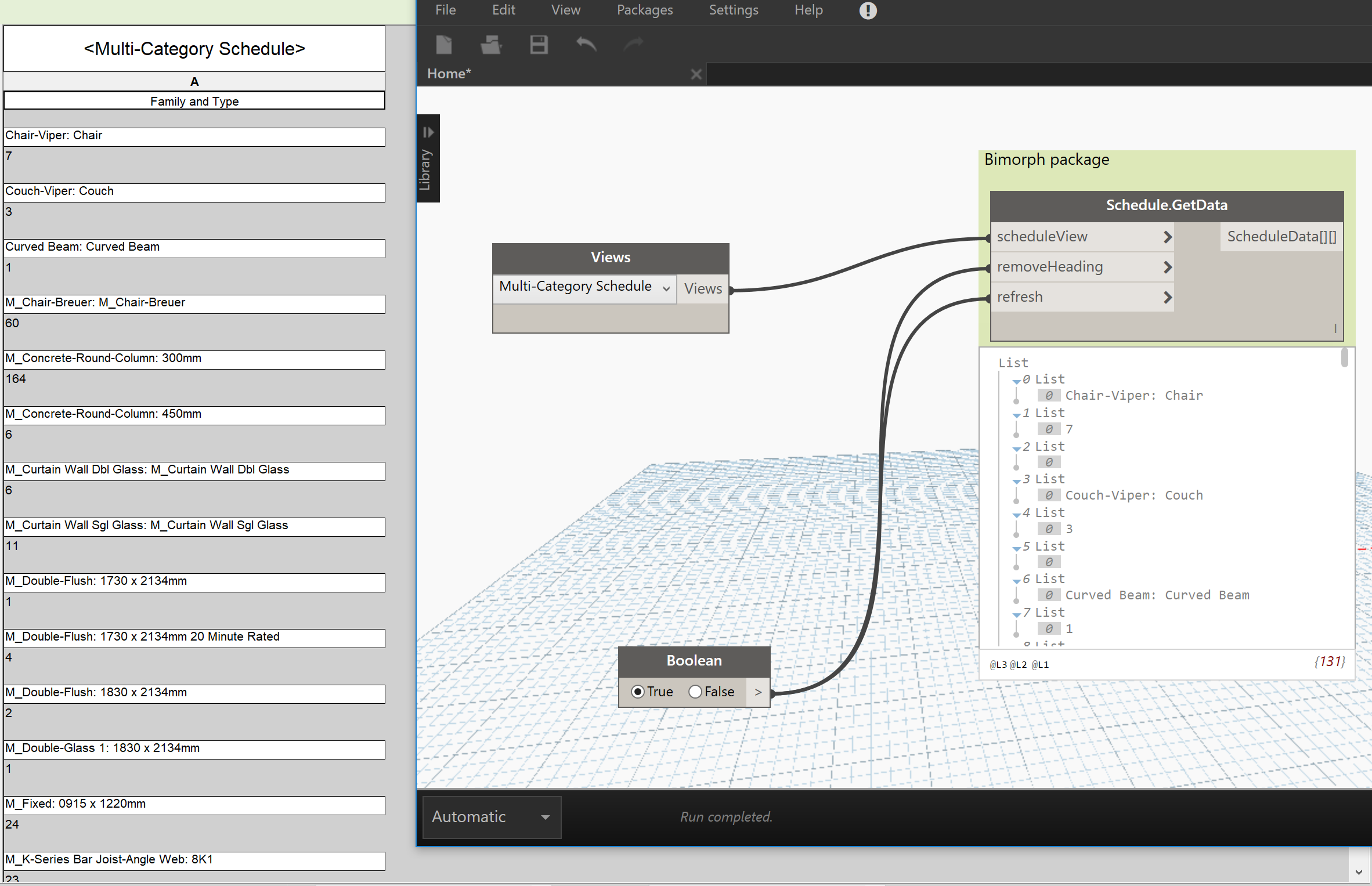

I would just create a multi-category schedule to count the families.
Bimorph has some useful nodes for exporting the schedule if that is what you want
That could work. I will look into it. Create the schedule then remove it after or it can just be left. Maybe it could be a template standard too. Should not add that much to a file.
Thanks Andrew,
Edit:

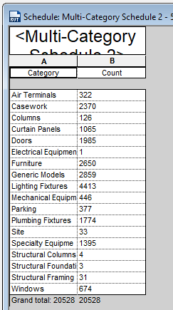

Looked into it a little more. Multi category Schedules do not supply Detail Items or annotations. Took roughly 15 seconds to set up though and reported 20,000 elements. This would be a great way to significantly reduce the amount of elements being called in dynamo. Great work around for what I am trying to do.

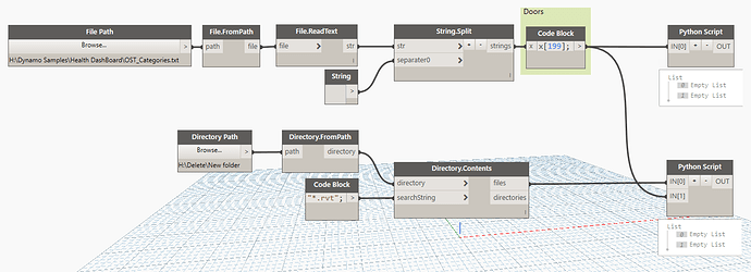

Thanks @Ewan_Opie Ewan,
I tried what you posted but it is not working. It just keeps exporting an empty list. The formatting was off a little bit in your code so I added the appropriate tabs and such. I have confirmed there are doors in the open project and and the project I specified to open as well as feeding the door category.
Do you see anything wrong?
Elements_3.dyn (10.1 KB)

Your code in the Python node is fine.:+1:
Its just a bit picky, and wants to have lists as inputs not single elements. :wink:
I am smart I promise. Thanks for the help with the code and laps in thought.
The code you provided is a defiant solution to collecting all the data. Collected over 300,000 elements in about two minutes. Now I will just need to manually cull through the Categories list to see what all I actually need.
Thanks @Ewan_Opie for a great solution.
