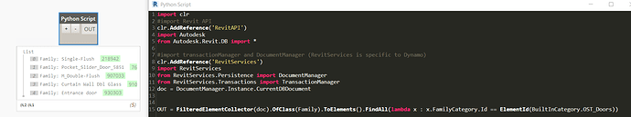

Another way
import sys
import System
#import Revit API
clr.AddReference('RevitAPI')
import Autodesk
#import transactionManager and DocumentManager (RevitServices is specific to Dynamo)
import RevitServices
filter = System.Predicate[System.Object](lambda x : x.FamilyCategory.Id == ElementId(BuiltInCategory.OST_Doors))
fec = List[DB.Element](FilteredElementCollector(doc).OfClass(Family).ToElements()).FindAll(filter)
OUT = fec
This is the solution Ive been looking for. Tested it in c#, it gives me a faster way of querying families.
@blsalvio And here is another method with one line code slightly different than @c.poupin :slight_smile:
hi @Kulkul
Thank you very much. Your code differs with @c.poupin a little bit but when I convert it to c#, it is exactly the same. I am just doing scriptlets in python and if successful, I implement it in c#. Right now, my job is to optimize code and make the existing scripts and nodes faster and efficient to handle hundreds of thousands of elements in one model.
Again, I cannot thank you enough for the suggestions you have given me.
