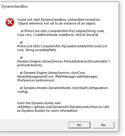

I have literally just downloaded version 2.6.0 of Dynamo Core from
https://dynamobim.org/download/
and am getting this error? I have Autodesk software installed which I have seen can be a problem
Does anyone have any Ideas?
Hi @jonny.pye can you verify you unzipped the .zip with 7zip or otherwise manually unblocked it before unzipping?
It was unzipped using the windows unzip, I just tried using 7ZIP and extracted it again and that seems to have fixed what ever it was. thank you
