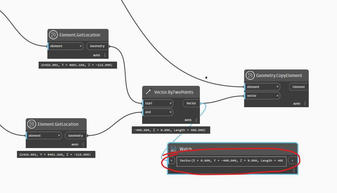

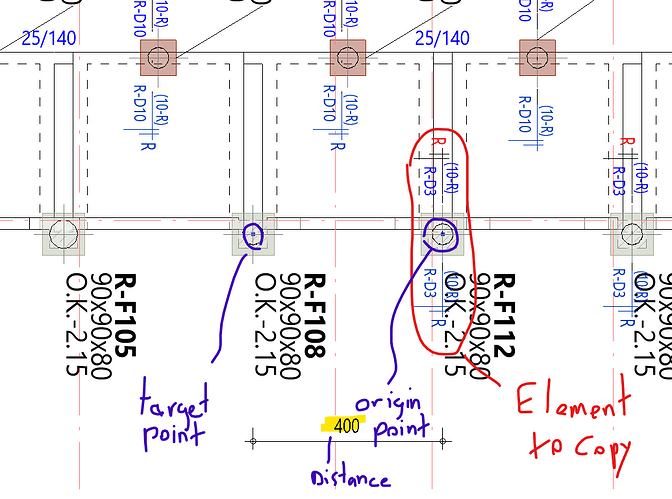

I am trying to copy an element of replicated section using the CopyElement node. I select the locations of current position and the target location (marked by the two dots in image) and I create a vector that describes the proper dimension.
Problem is that it is copying but not transferring the full distance of vector.
Appreciate any insight’s in the matter.
Element to copy, origin and target point:
Vector describing proper distances:

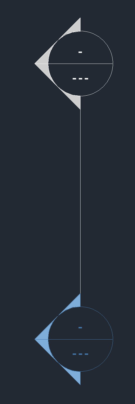

Duplicated element. Not transferred full distance of vector:

im not seeing ur full graph, and this is solely based on my intuition. simply put:
  • Duplication happens on ViewSection element.
  • Movement happens on the bluish section symbol (for lack of better word) which is the one u actually want to manipulate with the vector.
There are other nodes/methods for copying elements but you can always provide a vector with no translation (0,0,0).
To @BimAmbit’s point, we can’t see the rest of your graph to know what element you’re attempting to move or what the “location” of that element actually represents. We need to see your full graph.

It’s as @BimAmbit stated, the section element.
