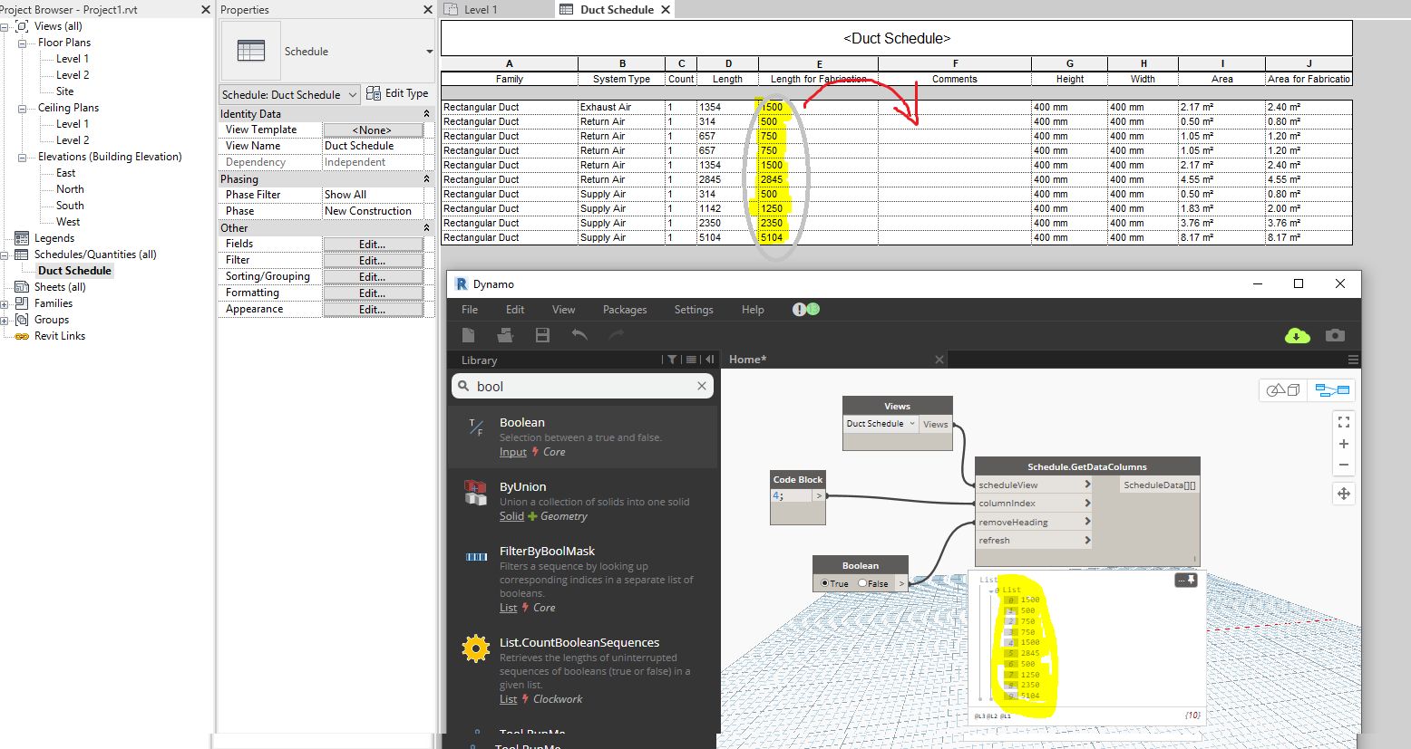

i m trying to copy/paste data of one column in Revit schedule into the other. Is it possible? For examle i have some calculated values in schedule of duct and i want to copy this value to another parameter (for example to comments). I found in BimorphNodes package this algorithm Schedule.GetDataColumns but i dont know how to Set this data to another column.

you need to copy / paste the value to the actual parameter from the element.
In your case that would be get parameter value > set parameter value to the “Comments” parameter
something like this:
Your elements could be all elements of category: Ducts for example

I m afraid its not that easy, because for example if i have some filters in my schedule, i have to create it in my script too (you cant use all element of category), or if i m using some sorting/grouping in schedule i have to create it in script too, or maybe I did not understand your answer well?
It would be great if exists something like Schedule.SetDataColumns

i m trying to create something like this:
I would like to copy parameter “Length for Fabrication” to my “Comments” parameter, just for this example - for all ducts, when i try to use somenting like this it shows me this solution:

Hmmm… so it worked for a single instance? Can you try setting parameter by name to Longest Lacing?
Edit: It would be helpful to ‘watch’ the outputs of your nodes…
You are feeding a filtered list to all elements of category… lists will not be equal i think.
if you use my solution of post 2. it will write comments to all ducts but your schedule will still be filtered the way you did. this way the ducts you dont want to show, will not be shown.
I think you have a point… the set parameter node is being fed values… it needs elements…
The best thing to do would be to get all ducts, filter them by the schedule value, then copy the schedule value using set parameter…

When i try to change setting parameter by name to Longest Lacing it shows me this:
147
That’s really interesting that it kind of worked at all!
I wonder how that node is working :slight_smile:
I think it would probably have the same outcome if you did Level 2 and shortest lacing…

your data is written to the elements, but they are not in the same order as they are in the schedule.
Use Yoeri’s approach in post 2
Hi Marcel,
I think the OP is saying that data in the schedule is being calculated so you can’t just pull it from the elements.
If we sort both sets of data by Area, or something… maybe that helps?
or build the calculation thing in dynamo
If you know the fabricated sizes its just round up to first available size. this should be easy in Dynamo.
it looks like 0…1500…250 = prefabricated
and >1500 is custom made?
the value of 5104 makes me scratch my head, it doesnt seem to be a calculated value
