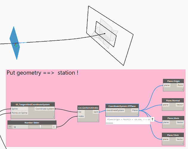

Hello ! How to put geometry in the same position as this station (Blue) ? Not only with the same (X,Y,Z) but also the same orientation perpendicular to the path. PS : The ZAxis on the “global coordinate system” is not always perpendicular to the path. o

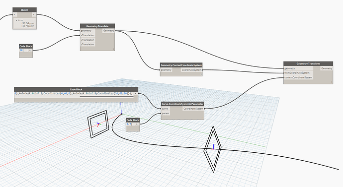

Have you tried Geometry.Transform?

Hey Vikram,

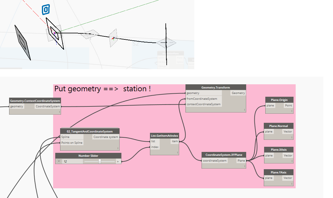

Yes , but there is something messing !
I think you need to invert the inputs of “from coordinate system” and context coordinate system :
