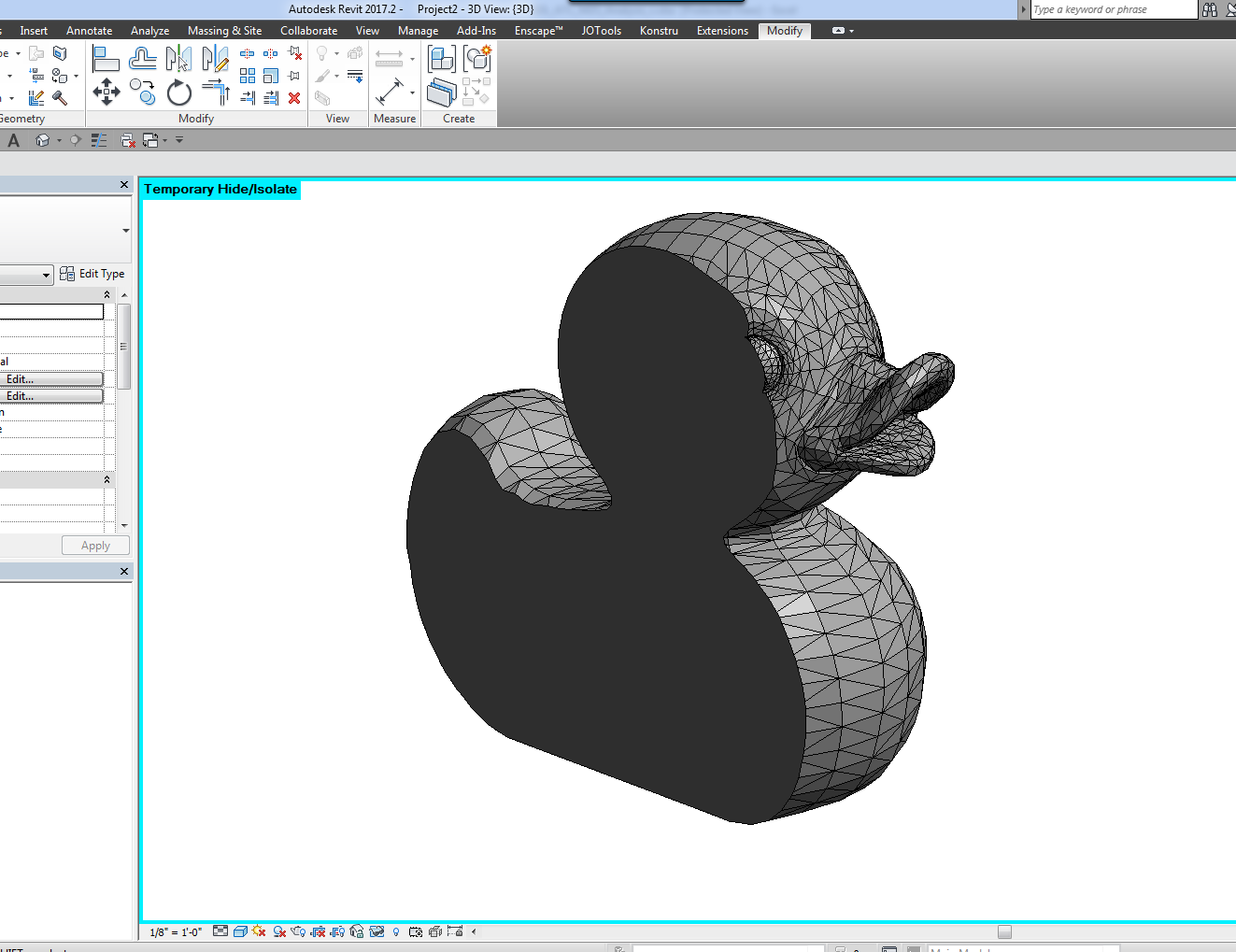

I am interested in converting a watertight mesh (Toolkit Mesh) to a solid. I have searched the forum and only found methods for converting topography-like meshes to solids using thickening in the downward direction. I guess what i am curious is is there is some method for enclosed (watertight) meshes like Mesh.Fill that essentially fills the void space in a watertight mesh to get a solid rather than a mesh.
I’m not sure how either of those converts to a solid. Mesh.FaceVertices returns points, and the DirectShape node simply converts the Mesh to a Direct Shape element in Revit (but it is still a mesh if you dig into it’s geometry via RevitLookup).
I’m interested in getting a true solid so that I can get solid properties like volume (for weight calculation) and centroid (along with all the other capabilities of solids like intersect and difference)
Mesh.Triangles + Solid.ByJoinedSurfaces may give some results…
Duh…I feel like a newbie. Thanks @Yna_Db.
No merit, we just played somewhat with that recently
