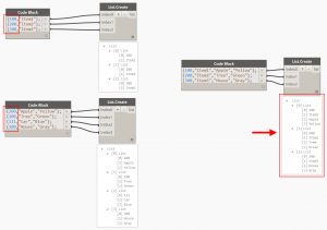

I am trying to combine two lists to one list based on the same code in Both lists.
Please see the picture below.
I have two lists
The first list is a list with Items. every Item has a specific number.
The second list contains Item description and color.
In this list are the same specific numbers
Based on the number in list one I want to search for that number in list two combine the info to a new list.
Any suggestions how to manage that in Dynamo?

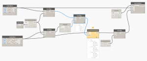

This may be a little more complex than what it should but is what i could think of to get you to your end goal from the beginning two lists.
Dynamo File: help
Vikram - i thought there would be a similar way to do exactly the same which you have proven there is:)
Great solution, Vikram.
I have a small suggestion. I think that back in version 0.8, they fixed a regression with node lacing and a lot of nodes that could not handle lists and needed a “List.Map” node, started working again. So that means that if you set lacing to longest, you can omit the “List.Map” node. That’s not the case with “IndexOf”, unfortunately. However if we use “List.FirstIndexOf” instead, we can get rid of that “List.Map” as well.
Didn’t even cross my mind that lacing could make the solution so much better. Thanks.
Very nice solution Dimitar, seeing the variation probably helps with getting to know the software and how things can work outside of what you may originally thought it was for.
Very nice indeed.

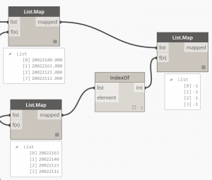

I face a new problem with this.
The top list is the data from Revit
The bottom list is the data that comes from a Excellist.
So one Item from the top list is not available in the bottom list.
This results in a -1 value in the List.Map and a error and null value in the List.GetItemAtIndex. See yellow Node.
This results in a List.Combine Node at the end. When I use this principle in my routine to update de Description it results in wrong information in the families.
Is there a simple way to remove the -1 index from the List.Map zo I get a list without the Null values?

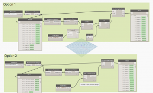

If you look at the attached image(option 1) which i had posted else where on this forum, it indicates what to do with the “-1” via doing a == node then filtering by boolean.
