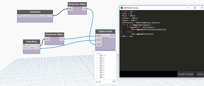

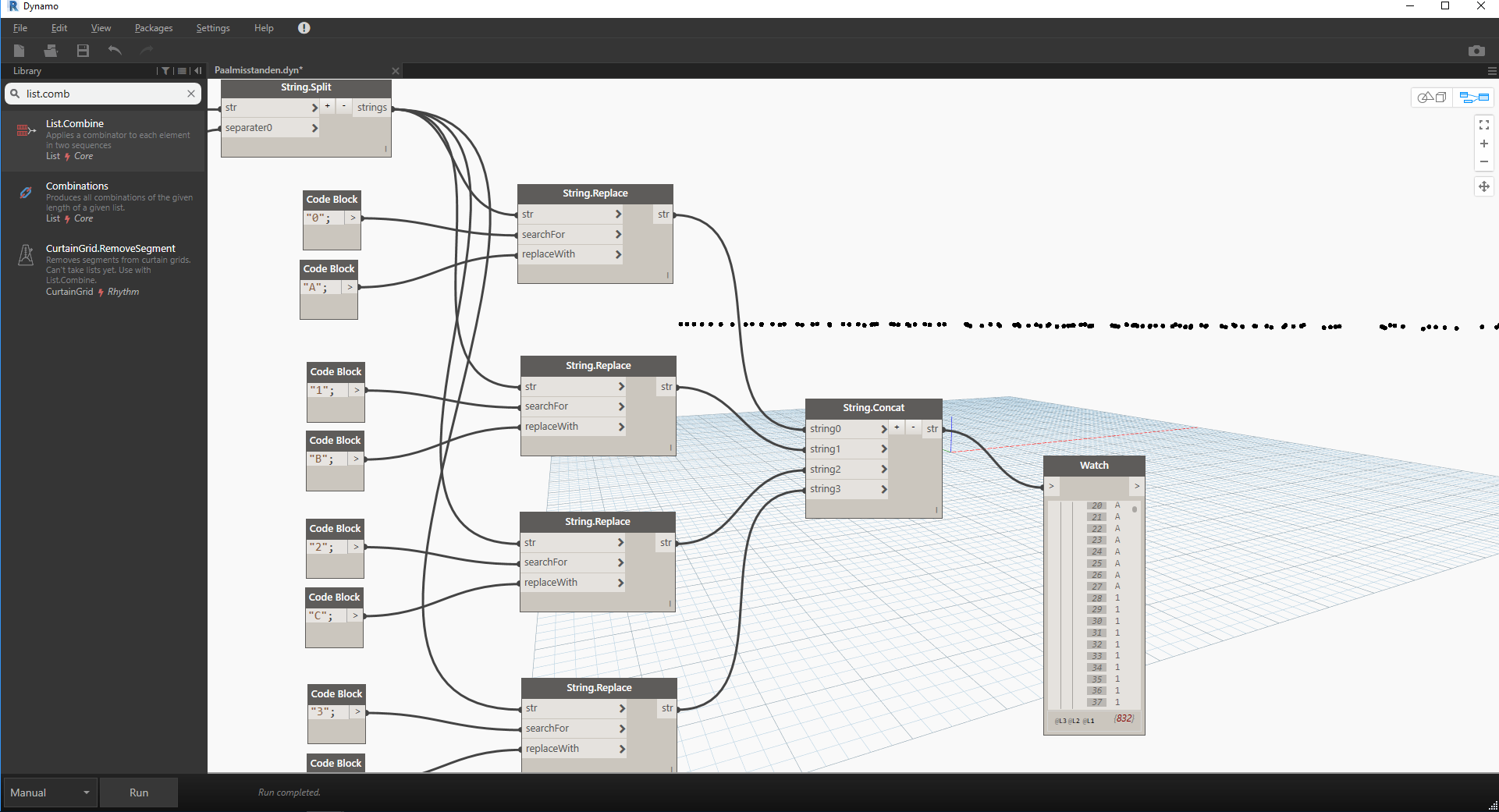

I need to get the value from a list without change the index.
first i get the parameter name then if in the string is a “0” replaced it with “A” replace “1” with “B” “2” with “C” and “3” with “D”
Now i want 1 list only with A, B, C and D without changing the index
