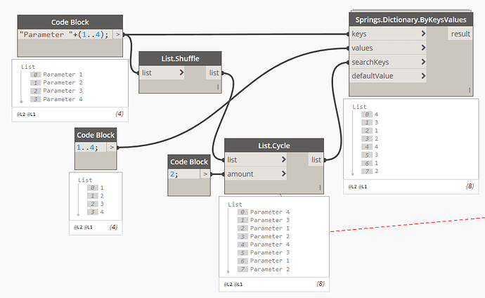

Something like this, now I want to filter the values for each parameter from the list by typing the name. So here in this case, that would be, I enter “Terrace” and the list gives me the value for this would be 17.99. I do not know if I could explain it well what I mean.
I’m not sure what to do about your blank parameters but I think you’re looking for a dictionary. You specify which values go with which keys (parameters in your case). Then whenever you give the dictionary a key, it returns the specified value.
Great:+1::grinning: Thank you again!
