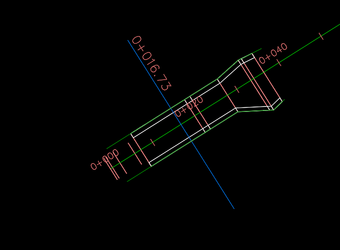

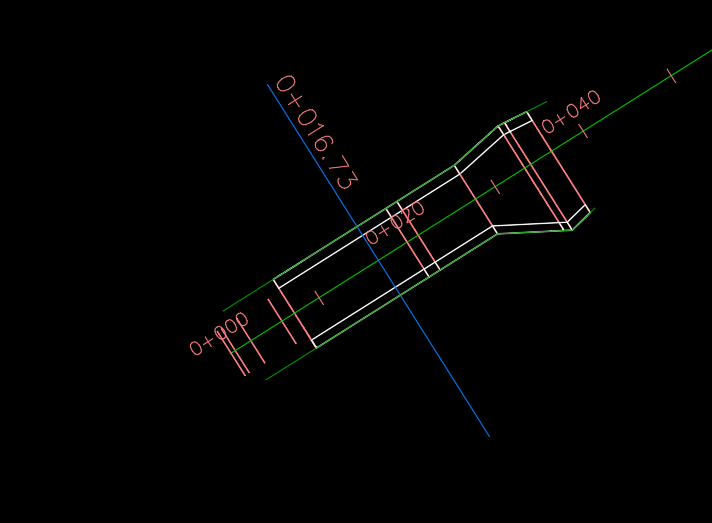

I create an assembly with offset target left and right use it to create a corridor in Civil 3d and use the civil connection package to create a solid geometry in revit. Corridor shown with in civil 3d is correct.

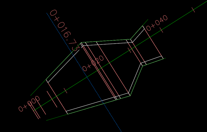

but in Revit it show smooth edges.

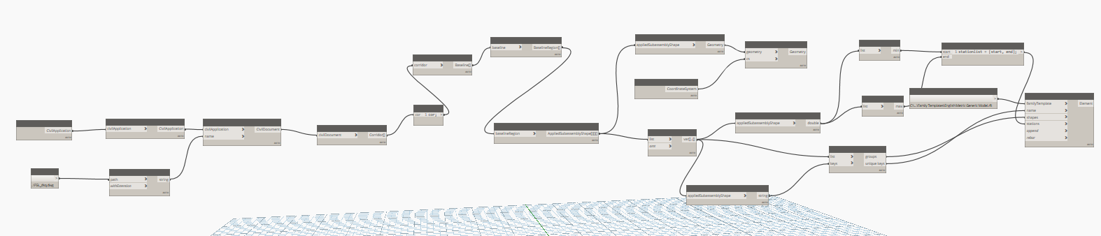

i manage to remove the smooth in the revit using this script.
civil 3d corridor
revit solid
Are U mean delete BaselineRegion.Shapes?
I have sth like that
