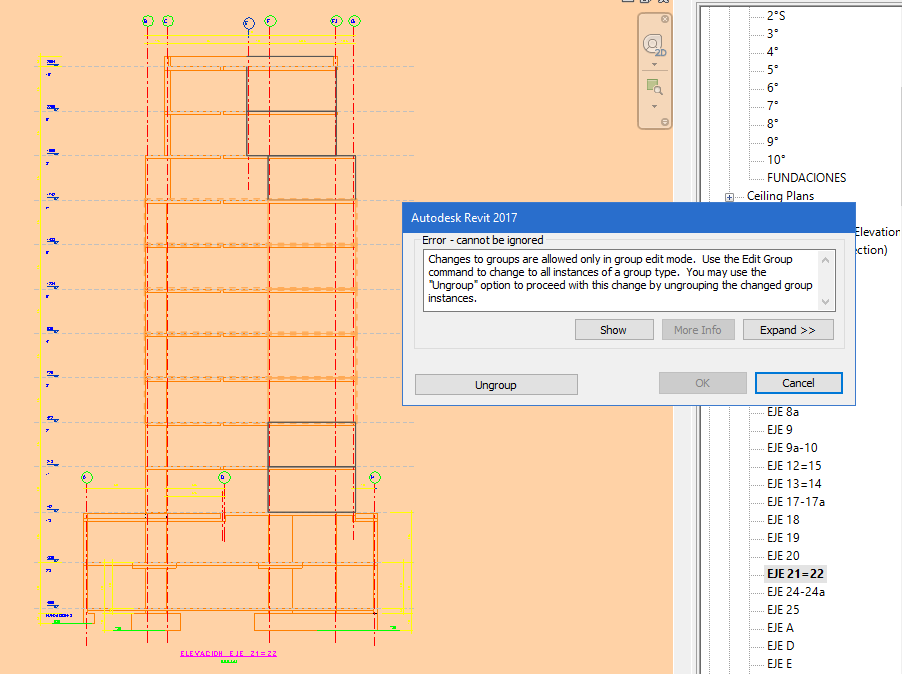

I want to change element parameters in a selection of elements, but some of them are part of a group. For example, I want to change a custom parameter of a wall but I get an error saying the following:
Not possible without ungrouping. You can however update element parameters that are in groups by making sure the Project Parameters can vary per group Instance is checked. If you are using the aligned by group type for the parameters, its game over unfortunately.
No need to. Say if you have doors, some in groups others not, just collect the doors and update the required parameter. Just take note of what else I said.
