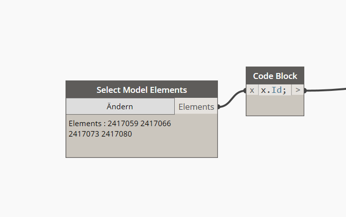

is this even exposed to Revit API ? We use it in the context of PropertyWizard but it is cruzial for Dynamo scripts. So either we forbide creating groups in our project team (it would lead to burning cars) or we try to enter the group elements to change…
