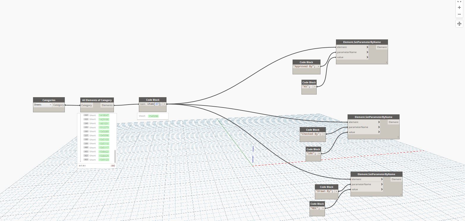

Changing individual sheet parameters
I WANT TO CHANE THE PARAMETERES OF INDIVIDUVAL SHEETS WHAT I HAVE. I TRIED THIS CODE BUT WHEN I RUN THIS I AM GETTING THE BELOW ERROR. GIVE ME SUGGESTION .
Warning: Internal error, please report: Dereferencing a non-pointer.

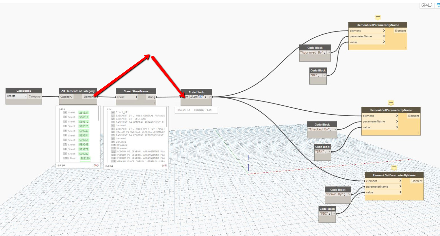

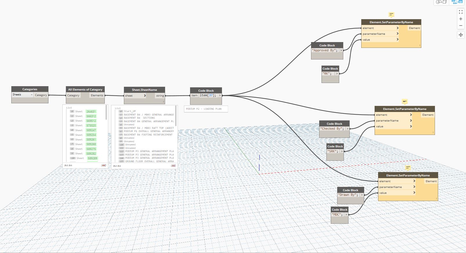

@rajkumar.kolli93 you are passing strings instead of elements
Take out the Element.Name node and pass the All Elements of Category straight through to the code block “item[37]”
ok thank you.
Oh thank you Its working…
