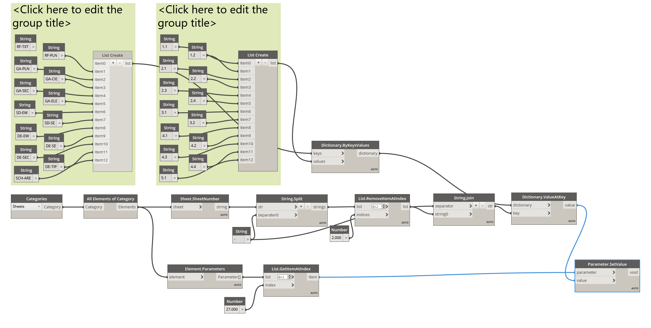

Because all of these parameters have to be entered manually (wich is super tedious btw), I wanted to come up with a Dynamo script that would take the first characters from the sheet number parameter, and complete the Order field based on that.
I´m VERY new to Dynamo tho, and so far I could only do this. I don´t exactly know how to continue or if this is ritght even. I could really use some help.

First, I split each of the strings using a hyphen which turns each sheet name into a list. I then remove the last item and join the first two items back together using a hyphen as well. Since I have associated each two-part code with a number (e.g. GA-PLN : 2.1) I am able to use the same value I extracted from the sheet name as a key. So, it will look for GA-PLN in the dictionary and return its corresponding value.

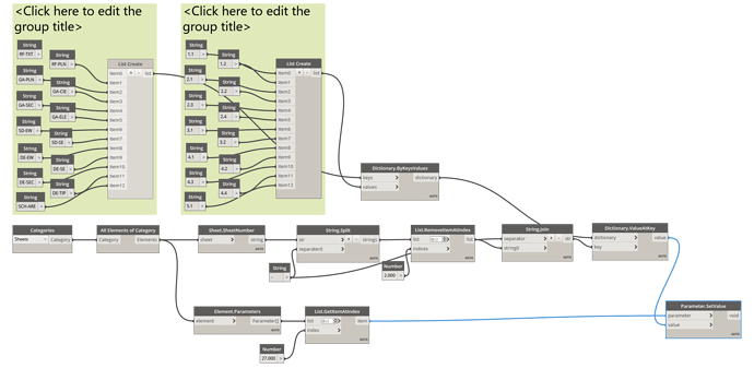

It didn’t present errors, but it didn’t change my sheet’s order number. I believe the problem is the sheet number has two hyphens, and maybe the script fails to recognize that as the same value. OR, (most probably) it’s that I’m doing something wrong?
Can you show the output of each of the nodes as you did with the first post?

we must flatten the list of results
Akli is right, your Dictionary.ValueAtKey is returning a list at L3 whereas your parameters are at L2. Flatten the list from Dictionary.ValueAtKey by 1 level and it should work.
It worked! Thank you guys so much! :smiling_face_with_three_hearts:
