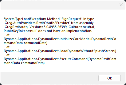

Anyone else having this issue again in 2026?
And the swap of the file isn’t working and according to Lookup there isn’t another version being loaded…

It actually appears that our internal toolbar is causing the conflict and presumably there is a dependency conflict with something Greg.AuthProviders is looking for because we do not use it directly.

The first step in troubleshooting stuff like this is to strip out all customizations and try to recreate the issue in a clean environment. If that doesn’t reproduce, close Revit, return a group of customizations, and try to reproduce. Repeat until you identify which is causing the conflict.
Attaching to a VS debugger can also help. :wink:
