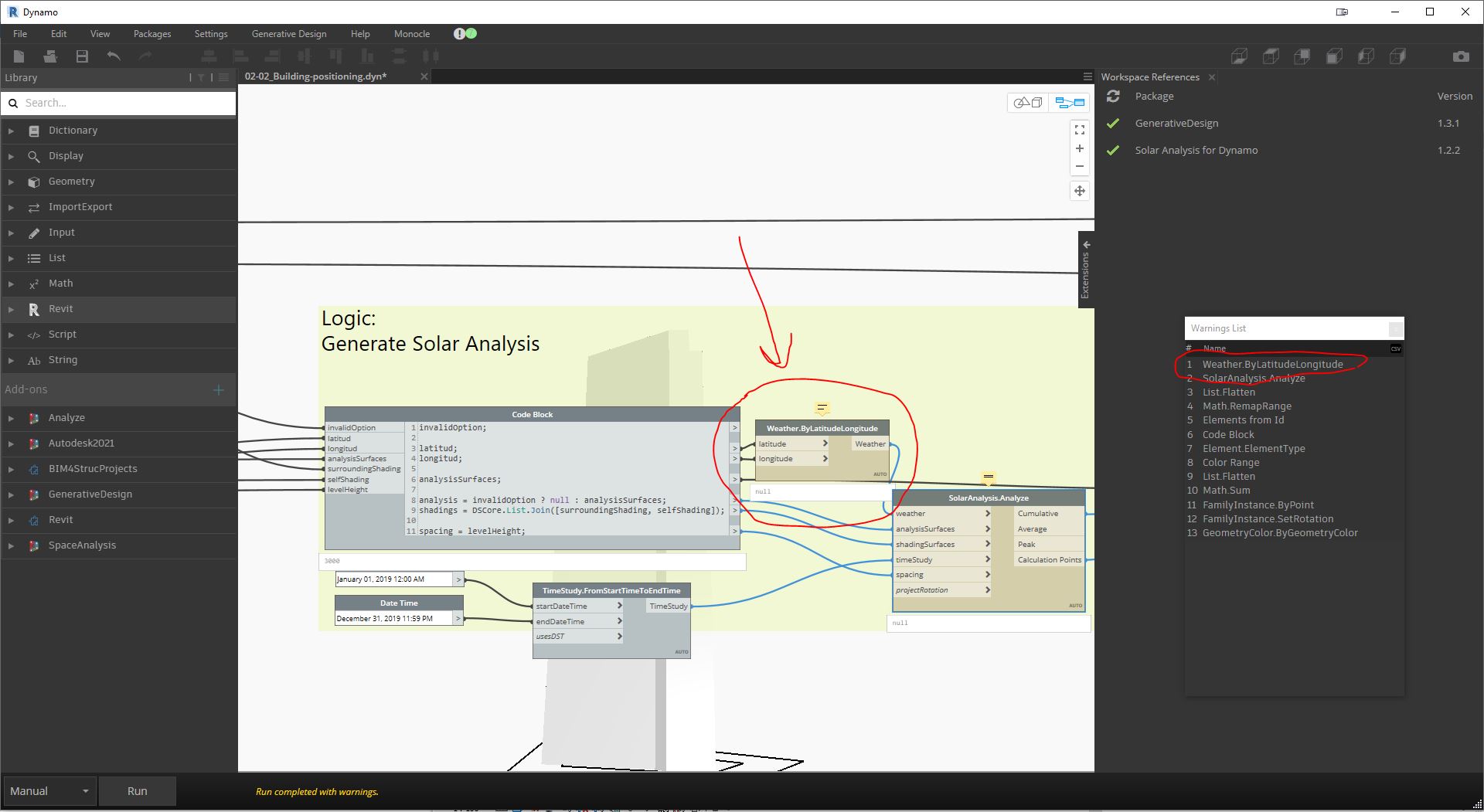

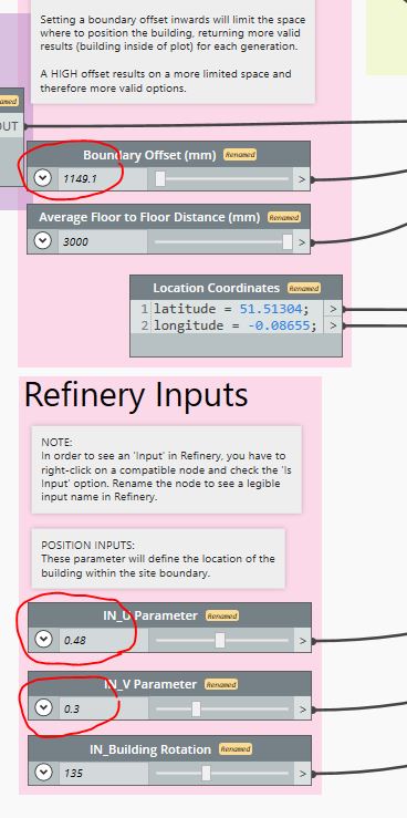

Generate Solar Analysis “Weater.ByLatitudeLongitude” gives an incorrect output (null).
Anyone see the mistake (see also fig. 1) ?
At first I thought the wrintig errors (latitud, longitude), but even if we correct this, things still going wrong.
Fig. 1
Thanks in advance.02-02_Building-positioning.dyn (3.5 MB)

Hi all,
We have currently opted for the workaround below:

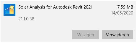

  1. Remove “Solar Analysis for Autodesk Revit 2021” (see also fig. 1)

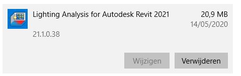

  2. Remove "Lighting Analysis for Autodesk Revit 2021 (see also fig. 2)
  3. Change Refinery Inputs (see fig. 3)

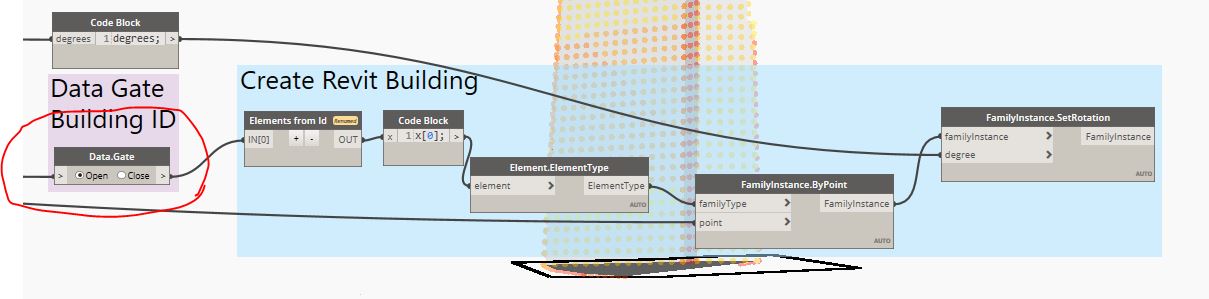

  4. “Open” Data Gate Building ID (see fig. 4).
  5. Dynamo script without warnings (Run completed) (see fig. 5)

@GavinNicholls @jacob.small @SeanP agree with the above (thanks for the help)?
Thanks also to @Mohammad_Asl and @Jose Bravo
I guess it works, but breaking software package A to fix code snippet B isn’t something I would recommend.
@jacob.small
Indeed it works. But we currently saw now other solution within Dynamo than the workaround described above.
