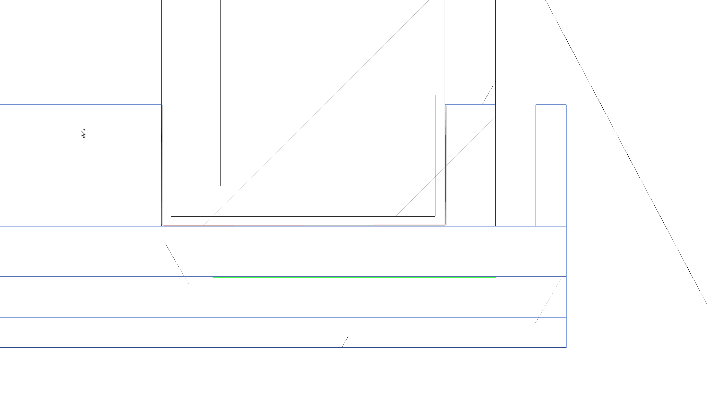

Is there a way to select and delete broken cut profiles? I’m not sure how they are getting broken, but whenever I print out a review set there always seems those green lines that indicate a broken cut profile.
I did a Revit snoop on both types and there are no apparent differences that could be used to isolate them.
Isn’t this Revit issue?

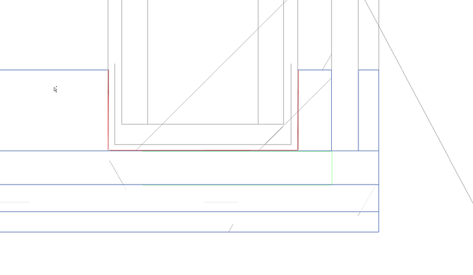

I’m not sure what you mean by ‘broken cut profiles’. They may be attainable via some means, but i can’t see any difference between the two in the screenshot you posted.
In the screenshot the redline is an unbroken cut profile. The green lines below it are a broken cut profile. Something has caused it to break and when that happens it turns green. It would be sweet to be able to isolate them so that I could 1 quickly see how many there are and then either fix or delete them.

I’ve attached ‘Project 1’, (this is one of 2 files I typically use to copy/monitor a family to make it not wall or ceiling based). If you look at Section 1 then you can see I made 2 cut profiles and broke one of them. Below is a screenshot as well.

This shows me where I can modify how they look, but I can’t isolate them or have it tell me anything about it.
I was hoping I would see something while snooping. I could have dynamo create a spreadsheet that listed all the broken cut profiles and what view or page they were on. I could then easily pin point them all instead of having to go through the project page by page to find them all.
